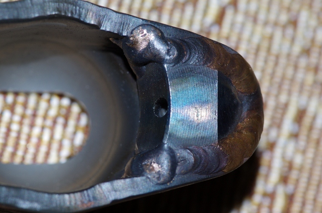

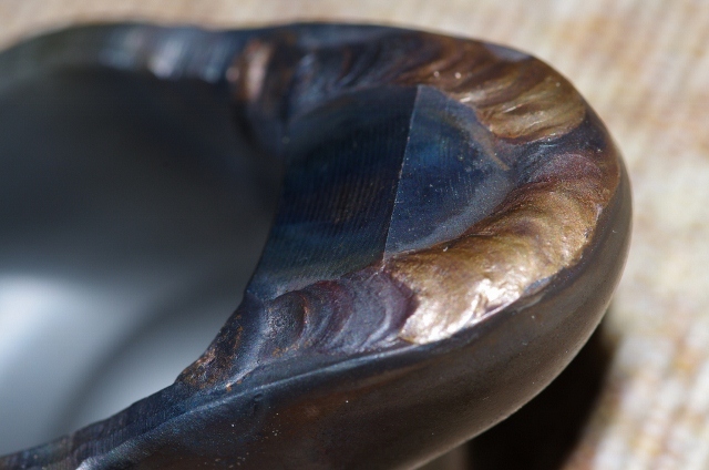

Default Re: Holroyd BBC Rocker Arms
Here are some close ups of Clarks work.
Name:	download april 24 11 060 (1024x678) (640x424).jpg
ID:	6980   Click image for larger version
Name:	download april 24 11 061 (1024x678) (640x424).jpg
Bill Edgeworth 6471 STK
Thanks...how about a bottom view on the pushrod cup?
Jeff Lee 7494 D/S '70 AMX
