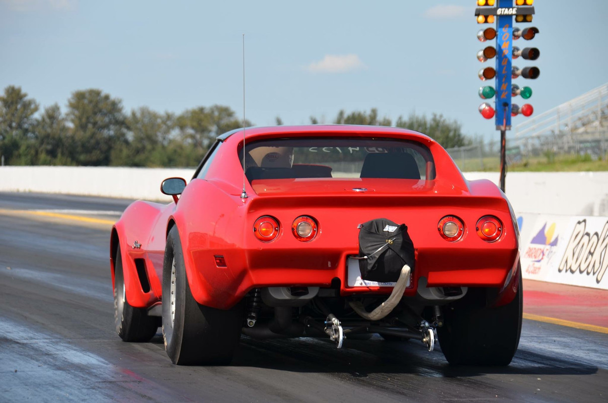

Thanks. I dont really have anything online and lost my phione that had a few.. Its been an evolving deal for many years. It was a street car until a few years ago. Eventually went 8.90's on a pump gas small block back then. That same small block is still there sort of but car now runs 7's. Car still has its full interior gauges, controls, power windows and period correct Pioneer Super tuner. Only missing stock seats as they dont fit with cage. Front end is all factory, steering box, control arms etc. Rear is a drop out 12 bolt with a short ladder bar. Penske shocks all around, anti roll bar, 7.50 cage. We run a 29.5x10.5 bias slick. Engine is a 416" Little Chief single 4 bbl backed by a Proflite trans. The majority of the chassis work has been done by Gary Hansen in Socal.
Ill try to remember to get some pics of it next time we have it out. Which is a few weeks from now. Were supposed to race this past weekend but weather cancelled the deal.

I will take some measurements next time we have the car out as I dont recall the exact dimensions on the housing. The fram rails are notched for tire clearance. The current wheels are 15x12 with 6" BS
AAs for the wheelstands its rare. Usually because we underestimated the track. The earlier pic was the result of one such error. And frankly the first time the car has done that in YEARS. These days it leaves really flat and hardly touches the bars.

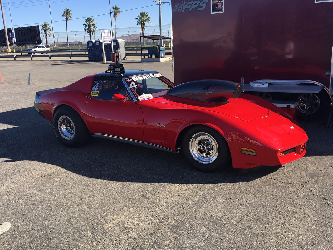

And here is a more current pic pf the car. Some of the front end "aero" was removed and car got some new paint.
