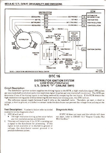

Interestingly enough, in GM F-body shop manuals, they actuall refer to the optispark unit as the "disributor ignition system."(see attatched) I don't believe one could quite classify it as a "crank trigger" looking at the way it works. Correct me if I'm wrong(being that I am primarily a FFFord guy), behind the cap there is a rotor that uses slots on a gear with an optical sensor to determine when a spark should be administered. This sounds to me to be more similar to a "hall effect" type distributor used in 80s fords and chryslers rather than a traditional "crank trigger." IMHO the rule should be written to include all fuel injected stockers in determining if crank triggers are allowed in stock or not.

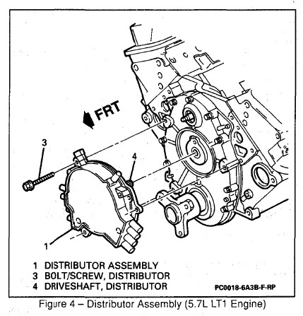

When the LT-1 engines and other EFI engine makes were introduced into drag racing, Jim Skelly was the guy that approved the use of aftermarket EFI ECU's and also approved the use of the crank trigger systems on engines that have a crankshaft position sensor in lieu of a single distributor that handles the ignition duties. The current language that everyone has used throughout the years was written by Jim and has not changed.
This same issue has taken place with other engine makes of ignition systems that have been previously approved by NHRA and later on deemed to be illegal only to be rescinded when NHRA found the original acceptance.
Below is a depiction of the OEM crankshaft sensor position on the LT-1 engine and Jim did not see an issue allowing the use of a crank trigger system in lieu of the OEM sensor because they both perform the same function.
Yep. Someone should not have poked the bear!

I do understand the argument that you could consider a crank trigger as being some sort of crank position sensor. The issue is that the crank sensor was not used to fire the ignition in Lt1 cars. Lt1's weren't actually fitted with a crank sensor until 1996. The computer still is only using the camshaft position, determined by the optical sensor behind the distributor cap, to fire both the spark and injectors. The crankshaft position was actually fitted to detect any misfires by using crankshaft speed and position to determine if there is a slight drop in crank speed at a certain interval.
