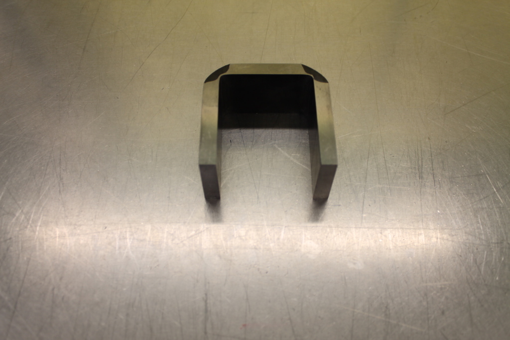

What is this instrument used for in a machine shop?
Could be to check connecting rods for straightness.

Another angle of view.
