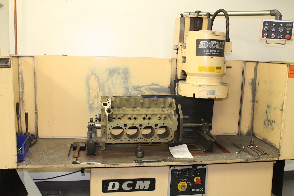

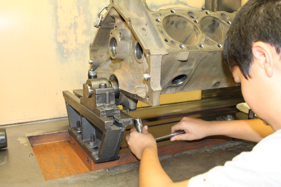

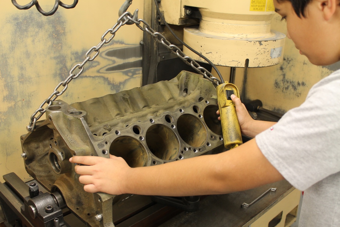

Last week I decked the block. My goal was to use the factory steel shim head gasket, this didn't work out, the block measured 9.013 on one side and 9.027 on the other, bad factory machine work, so I went 9.00 and set it up for a Fel Pro head gasket .038. I will bore the block next.
