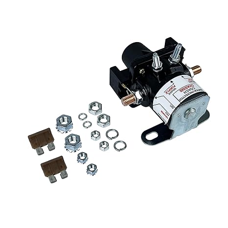

From what I've learned from 50 plus years in the auto trades ,yes the alternator manufacturers are correct ,the internal regulator can be damaged by shutting off while running.
I personally do not like having a hot lead at the alternator due to safety concerns of an internal short or other failure when the car is stored in the trailer or shop. My solution is to use a inexpensive marine battery disconnect relay between the battery and the alternator cable . the relay is controlled by the switched side of the master disconnect. I have not experenced alternator failures since using the relay and have had the power shut off tested at several National events. costs around $35 on Amazon
Name:	marine relay.jpg
