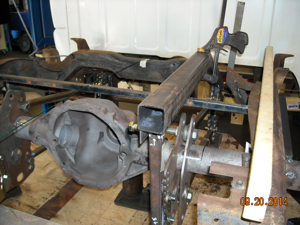

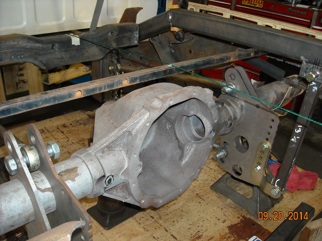

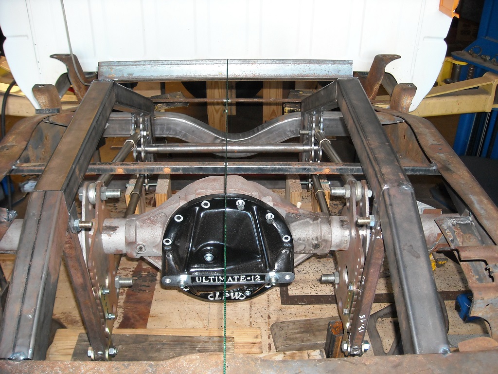

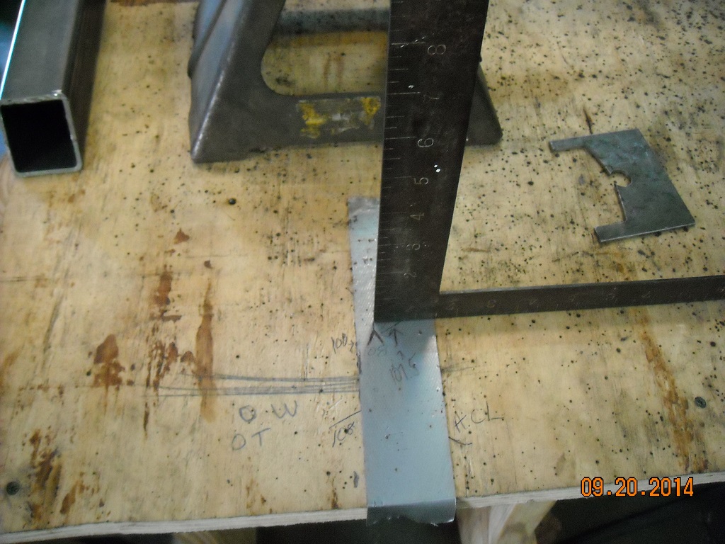

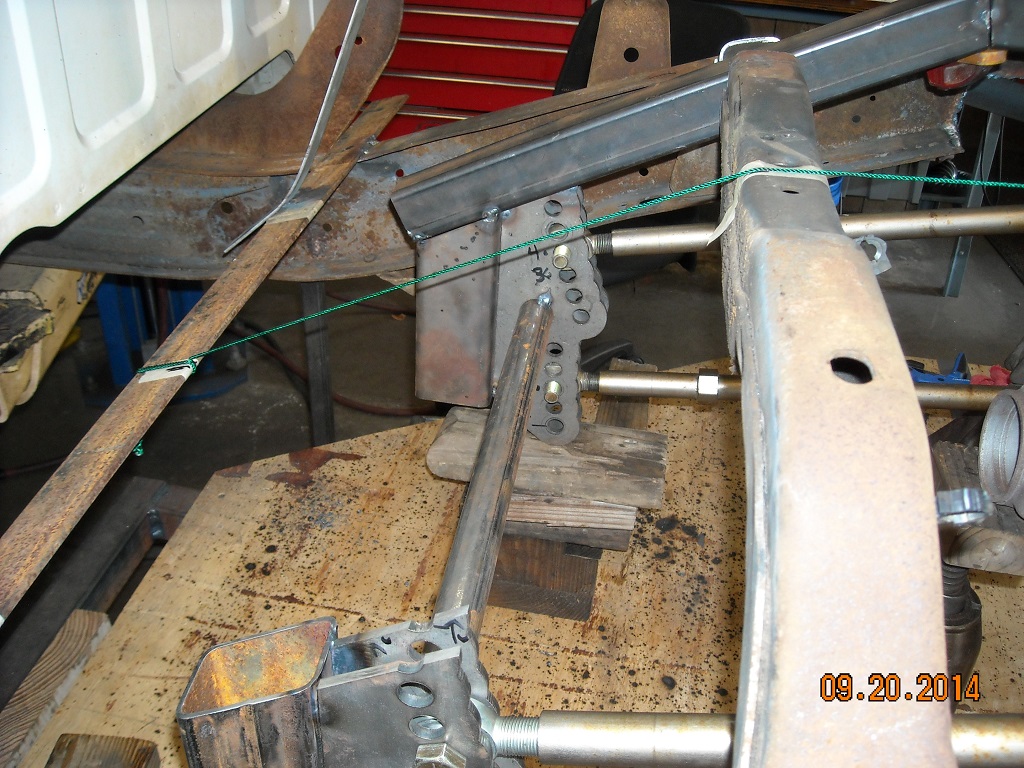

Your work must be accurate. In addition, you will try something and it will not fit as expected. Do not be discouraged. Walk away, take a break, give yourself time to think about the options.

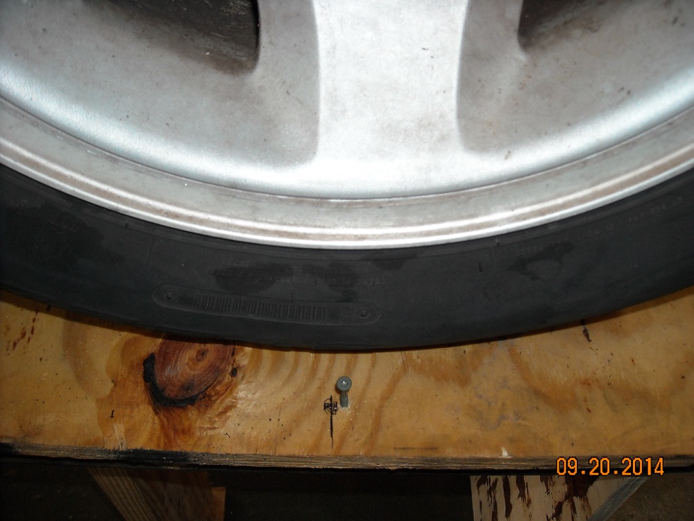

The first pic shows the front wheel base measure point. It is simply a screw into the plywood top that allows hooking a tape over.
The next two pics show the rear axle center ref on table and square bring center line up to housing

In the above third pic you can see a temporary strap holding rear housing in position. Also note housing center is 16" off table for 32" tire.

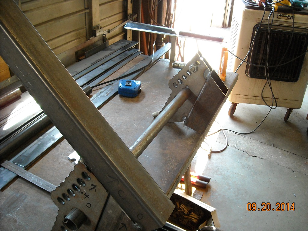

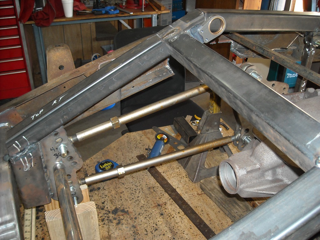

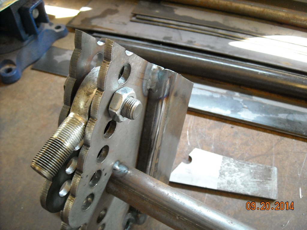

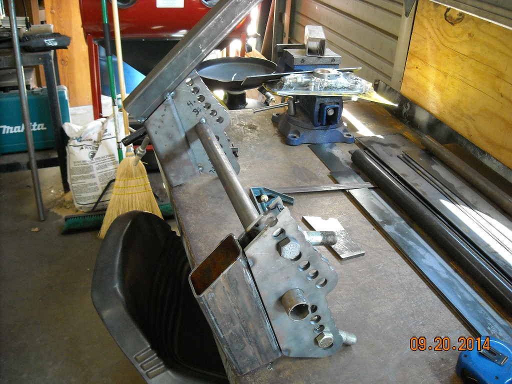

Next we see the shop built four link bracket assembly on the welding table.
It is an option to buy this assembly completely welded with frame rails. However, I built it in house for at least two reasons.
[1] money saved
[2] experience with fabrication and welding
The bar through the brackets is a temporary jig to help align the assembly

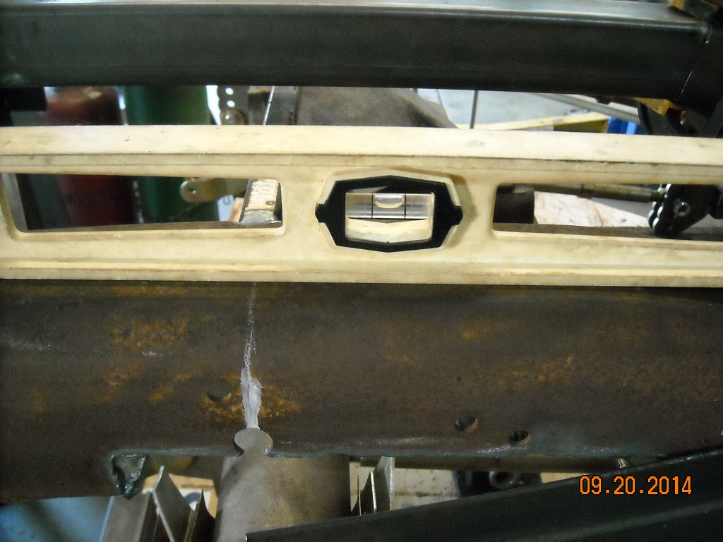

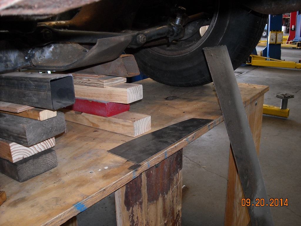

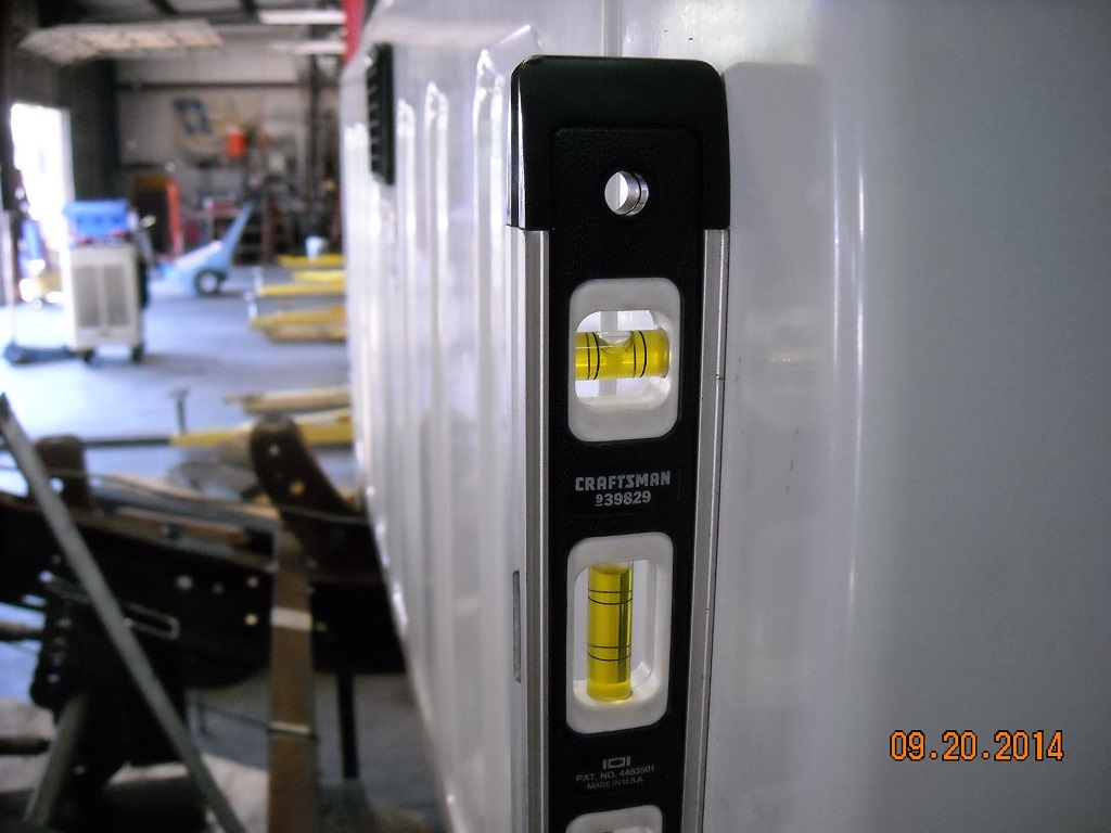

these photos show to keep an eye on your setup. Frame level, cab level, front crossmember blocked to ride height. The front springs are removed so frame can be blocked to ride height.

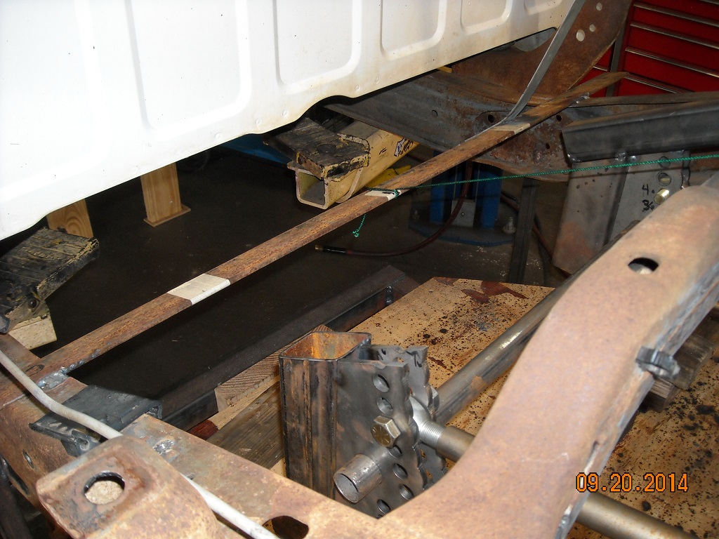

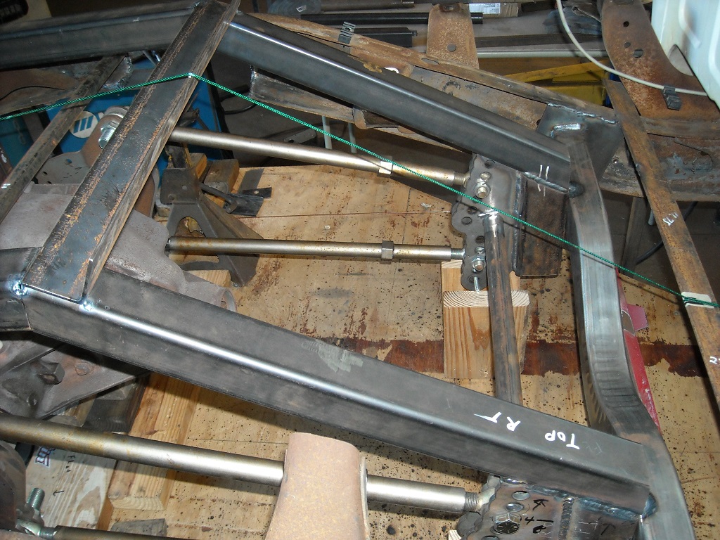

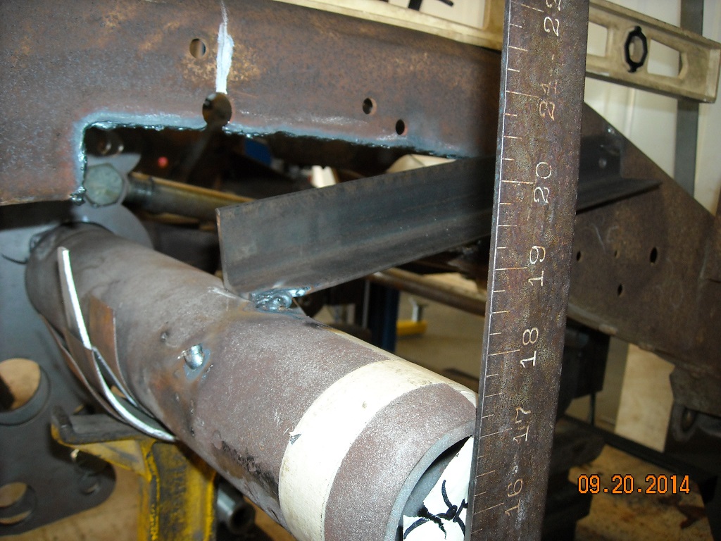

these pics show a temporary crossmember, center line string, shock setup bar, and rearward piece of new frame.
Next week will bring more rear section progress. Please stay tune and post any thoughts.

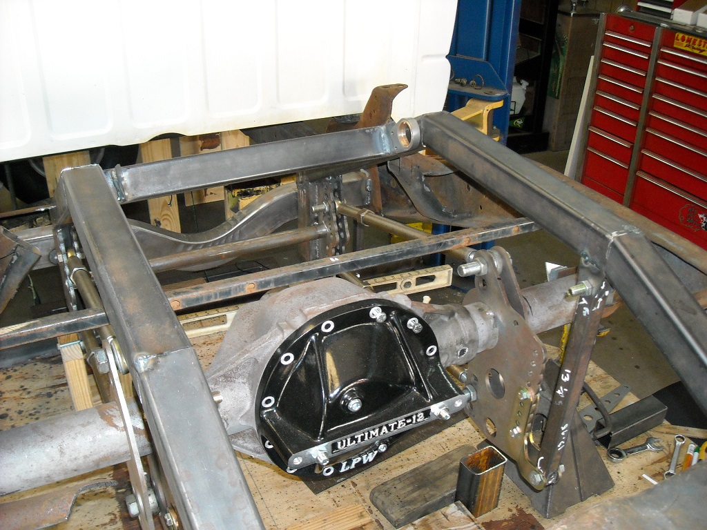

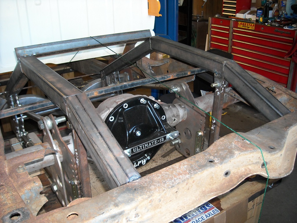

Friday afternoon Super 10 update.
There is good progress since the last post. This photo shows the new in-board frame tack welded in position. This is version "E" [ versions A - D were experimental mock ups ] That is my story and I am sticking to it
Notice LPW heavy duty rear cover for the 12 bolt. I have run the LPW with several other cars and I think it is a good idea that helps gear life.
Also notice the trusty center string. Measure, measure, measure, be patient, take a drink of water, measure, measure. I am now satisfied with the new frame rails and ready to finish weld all joints.
Other things to notice, [4] temporary crossmembers. All four will be removed after finished welding. And notice shock mounds and ride height jigs. All measurements check good, frame square, shocks same height, front four link brackets same height off table, rear housing at ride height, wheel base correct. Whew!
Did I talk about patience and measuring?
