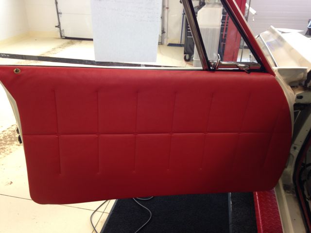

Legendary Interior just showed up today.......looks fantastic! Crimson red 330 Super-stock pattern. New door seals, and black headliner......oh ya!
Name:	door panel.jpg

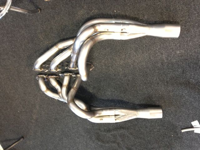

Hemi project update.....stainless headers from Performance Welding were delivered by my good friend Rick Paton {thank goodness for friends that share the passion of cars and racing!} Mark from Performance Welding is a artist, these headers a beautiful! I couldn't help myself I took them out of the box and installed them on my mook up block in the car. Only took about 20 minutes. All I need now is a empty BBM 727 and I can bolt it all together to fabricate some motor mounts. Still waiting for a spot to open up at the chassis shop to install the cage......soon I hope.
