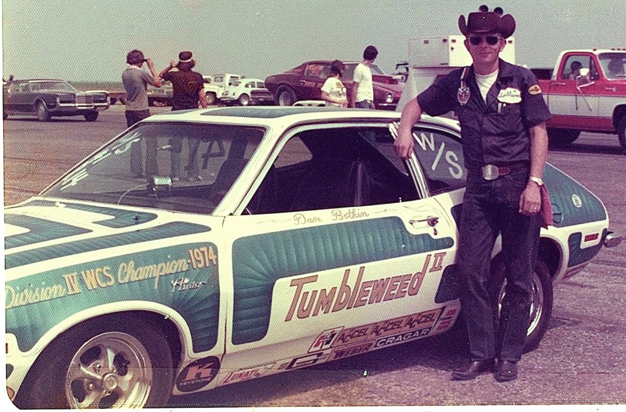

Pickup trucks immediately come to mind. Then there are all the wagons, & other real heavy cars. And, there are the 4 cyl compacts. We remember a guy named Dave Botkin. He had a little pinto named "Tumbleweed" that ran strong. He won a div 4 title with it.
Name:	Dave Botkin '75 .jpg

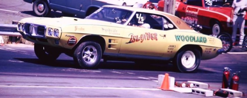

Found some more old Pontiac Stocker pics.
I've looked at so many pics lately, I can't remember all I've used in this thread. Maybe I should have kept a list. But I didn't. So, I'll rely on the mechanism on this site that tells you if you've already used & pic, & in what thread.
This 1st batch are '69 Birds.
Well, I'd already posted 3 of 'em. So, I'll try some other models.
Found 3 '68 pics I haven't posted yet.

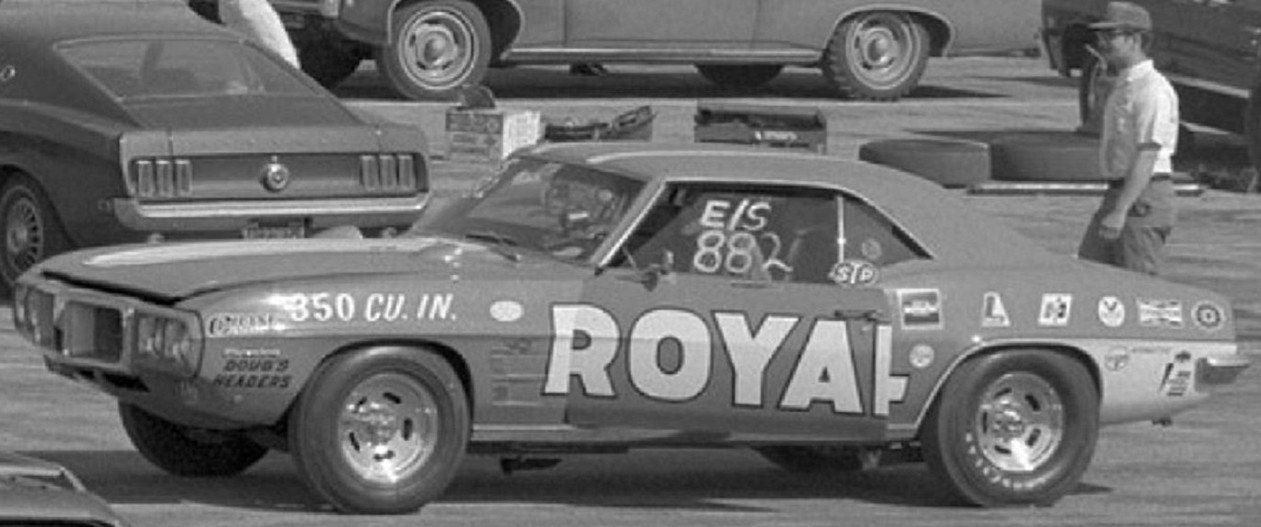

Name:	3 - Islander E-S .jpg
ID:	53650   Click image for larger version
Name:	'69 350HO Royal .jpg

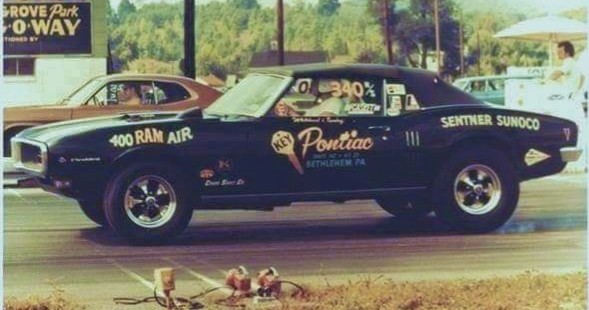

Name:	'68 Ragtop .jpg
ID:	53653   Click image for larger version

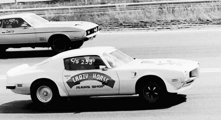

Name:	Crazy Horse C-S .jpg
ID:	53655   Click image for larger version

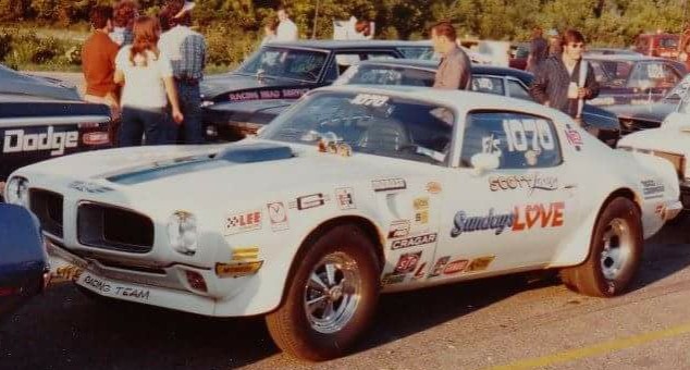

Name:	Sunday's Love F-S .jpg
ID:	53656   Click image for larger version

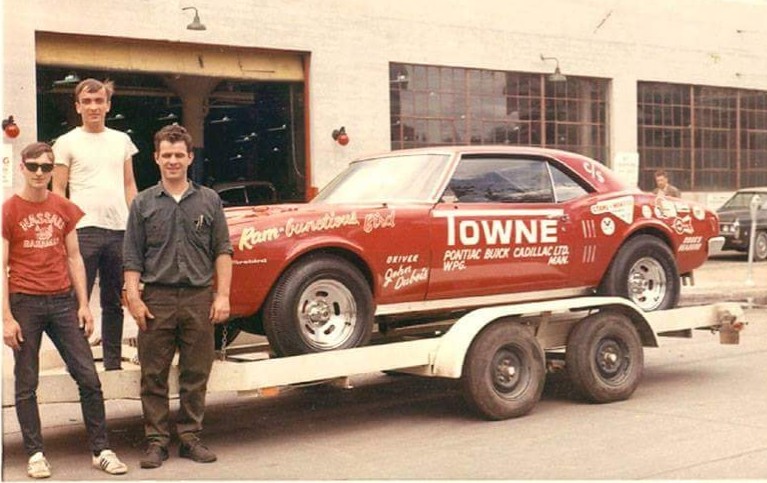

Name:	Towne '71 H-S .jpg

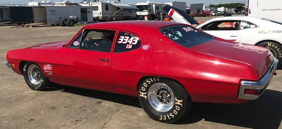

Name:	'74 E-SA .jpg
ID:	53658   Click image for larger version
Name:	70 E-SA .jpg

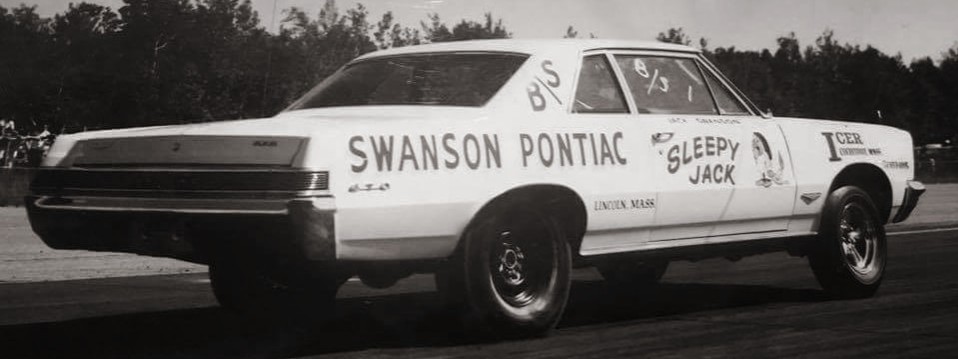

Name:	Swanson B-S .jpg
ID:	53666   Click image for larger version

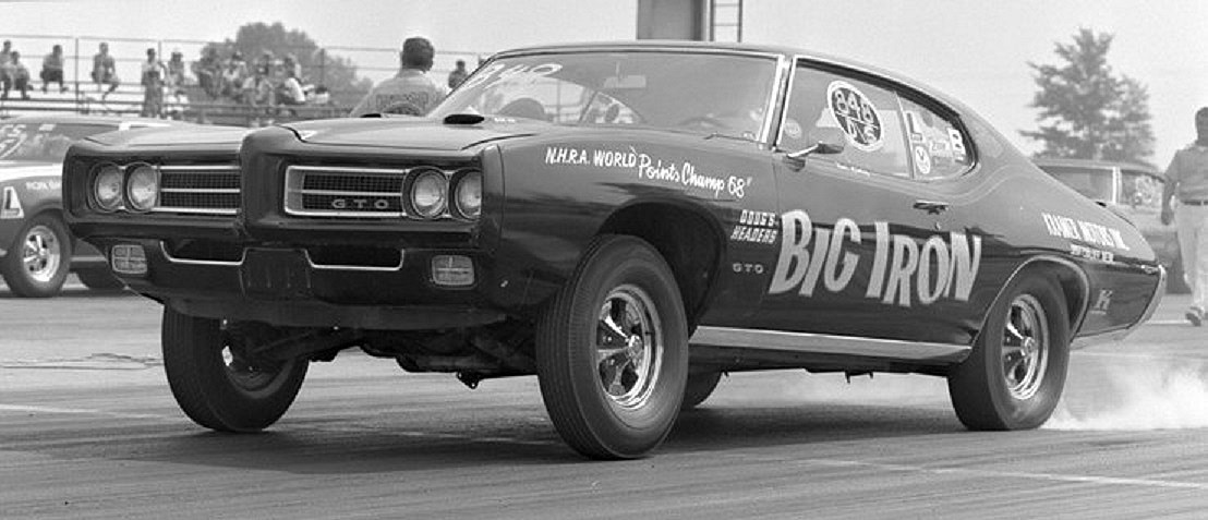

Name:	Big Iron D-S .jpg

Another combo I like is the '70 GTO, with the 360hp D-port 455. It has a 340hp factor. But, it's high compression. Only one of these cars running in recent years, that I know of. Don't know what an all-out build would do.
http://www.classracerinfo.com/Engine...0&MAKE=Pontiac
