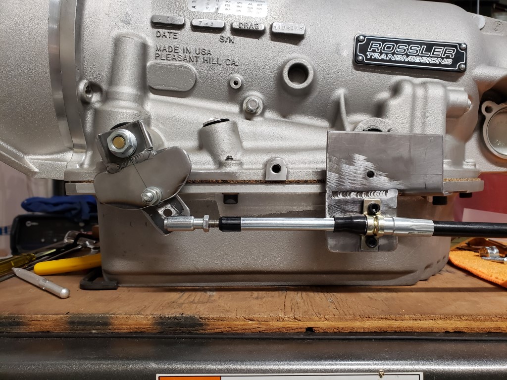

Here is a Photo of my Bracket & Lever......just after testing....Still some final "shaping" to do, but it finally works!

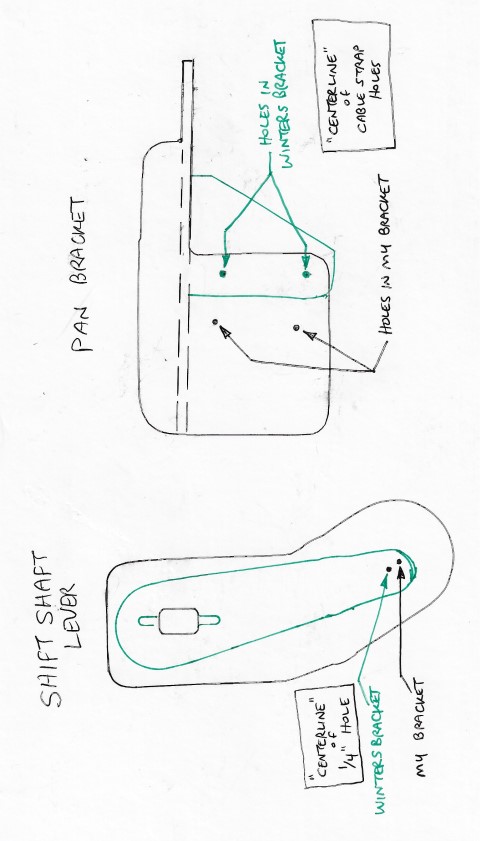

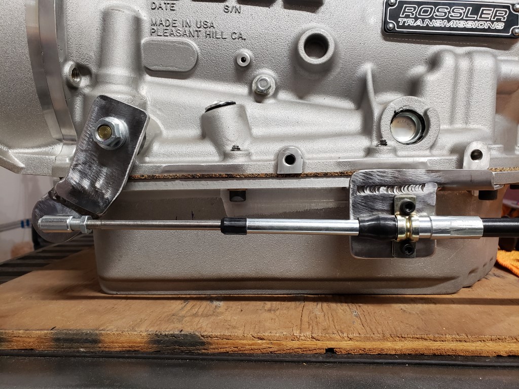

Here are the "FINAL" Versions of the New Shift Shaft Bracket/Lever and New Transmission Pan Bracket that I came up with to "fix" my Winters SideWinder Shifter-to-Rossler/Reid Case TH400 Transmission "mating" issues....Hopefully, it will help someone else that might be going through this same problem.
Thanks to everyone for their input!
Harold
