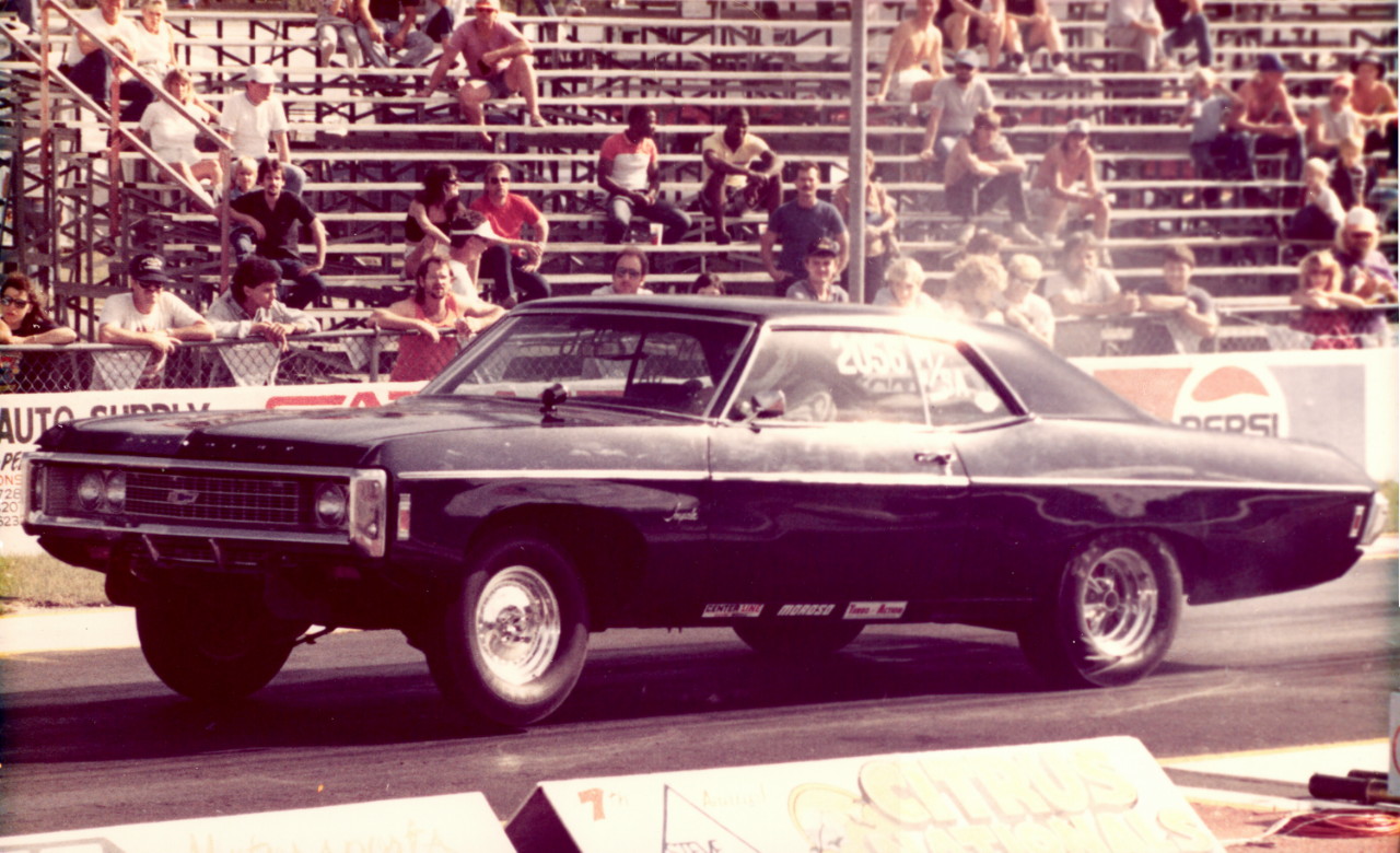

1969 Impala at Moroso West Palm Beach, FL November 1988
Temp was 85 Degrees, clear low(er) humidity day.
That was cool for South Florida.
This was the Impala's best ever run at 12.80 104 mph.
Never got a cold weather run out of it.
Index was 13.05, dropped from 13.15, from 13.36
Natural L, added weight to run M/SA.
Engine by Woodro Josey. Lunati Blue Print Cam
Back then could drop a class but not go up.
Won Points meet at WPB in 1983, Paul Forte won SS.
Engine rated at 280hp.
Weighed 4150 lbs.
Used street gas.
No Roll Bar required.
This car would have fit IHRA G/PS rules.
