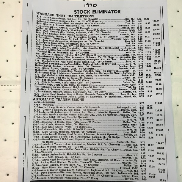

Originally Posted by DeuceCoupe View Post
That's the one, Hogan's Heroes, and I still remember the Gonkulator episode. So Ross on FordFE.com named my computer program the Gonkulator, WerbyFord got added, the rest is history mainly on that site but some others too, inliners, StevesNova, etc.
I just started Gonkulating all the early NHRA history, 1950s-1971.
Hard to find comprehensive real et/mph so I am compiling a list from books, web, etc. Graphing them is very revealing.
Rich just sent me a list of the 1970 record holders, only 3 1970 cars in there, I am guessing the car/engine since they just list the make:
H/S GTO 400/350 112.55mph
F/SA Cutlass W30 12.23et
G/SA RoadRunner 383/335 12.40et
Here is what Rich sent if I can get attachments to work.

I believe the CobraJet factoring was in super stock classes. Red Anderson once told me that the first stock factor was on the 255hp 350. The super stock classes from 1967 through early 1970s were the hotbed of factoring. When Stock was reintroduced in 1972, the SS factors were carried over to them. I know that the 396-375 Camaros carried a factor of 415 until 1981 from the efforts of Wally Booth, Bill Jenkins and others who raced them in SS.

Looking at the old class guide, the 1968-70 CobraJets were rated at 340 non-ram air, 360 ram air. The sheets have the NHRA oval logo at the bottom and the date 1970 beside the logo. The hp rating is not listed on the sheet, I had to calculate based on the shipping weight from current data.
The 1967-69 Camaros 396 375 were rated at 425. Interesting that they list a 1970 Camaro with an LS6 450hp.
Any others you need info about?
