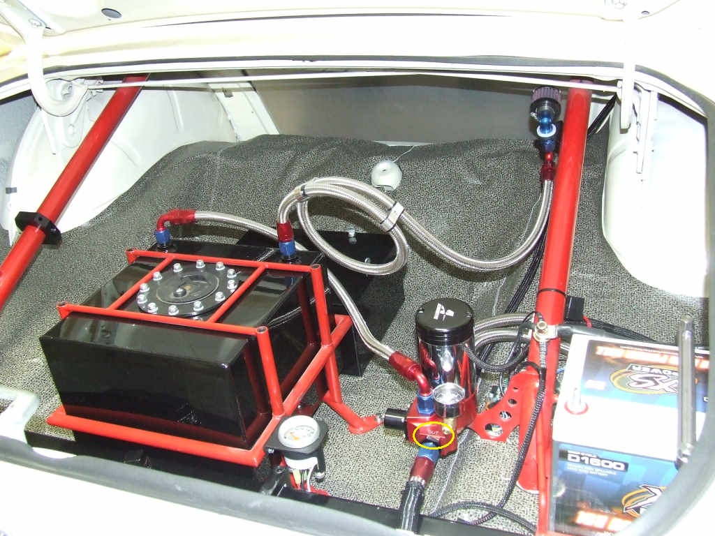

I just zoomed in on your picture and it appears you have the outlet facing towards the rear, which means your supply side is coming out of the cell and going around the battery to the front of the pump, that would cause cavitation if that's the case.
I thought I seen the same thing but wasn't sure.
Great catch Tom!
On the Ford installation, the fuel pump outlet is backwards and you can see the casting inscription "OUT" towards the rear of the car.
I have marked the area with the inscription.
On the Hemi car, the pump is installed correctly.
Also, in both installations, as it was said before, the venting has to be routed to the exterior of the car.

Originally Posted by Tom Nolan View Post
Aeromotive guy said the little bit extra hose will not cause cavitation! Only way to have cavitation is to suck air....the hose is full.
Tom, did you look at the picture in my last post?
I marked the area showing what appears the fuel pump outlet is towards the rear of the car.

Default Re: Failing Fuel Pumps
Cavitation can be caused by a low pressure area at the inlet of a pump and fluid will boil. With the pump mounted where g-forces are acting on the pumps ability to have fluid being pushed into it on acceleration it may be the problem for the mechanical failures. We run into similar problems like this on open hydronic systems.
Did Aeromotive give any reasoning for the mechanical failures?

I will turn it around. Thanks for your help guy's.

Hi,
With a filter installed in the supply line to the pump you have the potential to have a restriction.......
With a restriction you could have a negative pressure in the line causing the fuel to flash into a gas (vapor lock) and have pump cavitation which will destroy the pump....
I would recommend removing the filter between the tank and the pump and if you are worried about trash in the pump use a filter funnel to add fuel...
Hope this helps,
Bob
