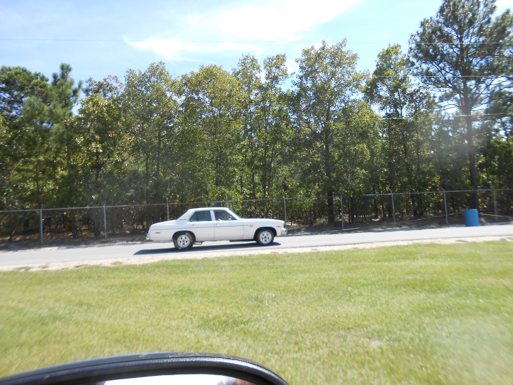

Mike has done an outstanding job on this project working on a budget. When he was testing at VMP in Dinwiddie, he had several folks come over and check out his car. It catches attention cause it's different. Not your everyday type stocker.
Amen!

Update - Tested at Fayetteville NC this weekend, BIG steady headwind.
Best of 14.97 @ 85.44, 60ft 1.923, 8th mile 9.23 @ 70.26. So it went under both 1/8 mile indexs and IHRA 1/4. Still need a little more for NHRA 1/4 mile (14.85). Biggest change was adding 18 more inches of collector for a total of 25". With this change, it seemed to want less jet than before. I had cheap paint on the collector looking for some to burn off, but that didn't happen. Seemed to be a semi-significant heat differential around the last 7" of collector(last 7 were cooler) so may shorten them there. Any suggestions?

What is your rpm through the lights? Maybe go to a 5:37 gear?
I'm considering that, or more. It's 5700 rpm right now. Is there a 5.57 for a 8.5 ten bolt?
I would like to try a smaller tube header, 1.5 primary but don't see any available, pretty much spent two days on the internet looking.
Also, I should say Joe Huestis is a BIG help on this deal, he was right there this weekend. Thanks for your help, Joe.
Motive Gear, Precision Gear, others have a 5.57 for an 8.5" 10 bolt.

Try Schoenfeld for the headers, they have 1 5/8 for the Nova
