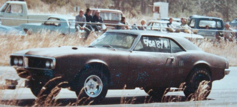

I've got a wire retainer story. And since it's winter, some of you guys don't have anything better to do than read an old racing tale, anyhow. It was the 1st race of the season in '75 at this little airstrip track, near Forest Hill, LA. We didn't even have the car painted or lettered yet. It was a '68 Bird 330hp 400 E/SA. When TJ ran the 1st round, we could hear the engine missing and popping. When she got back to the pits, we just loaded it on the trailer and sat down to watch the rest of the race.
Then we heard over the PA system that because they had put a car in the wrong class, they had decided to rerun the 1st round. So, we popped the hood and pulled the valve covers. We discovered one loose rocker, and the pushrod looked like it was too short.
So, we pulled the intake and valley cover and discovered the problem. The guts of a lifter were lying there in the valley. Don't know why they hadn't gone below. Anyhow, we put the lifter back together, adjusted the rocker and put everything else back on, just as the call came for us to come to the staging lanes for the rerun.
So, TJ fired it up, backed it off the trailer and won the race that day. After that deal, I never trusted the flimsy paper clip retainers.
