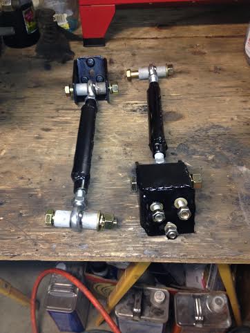

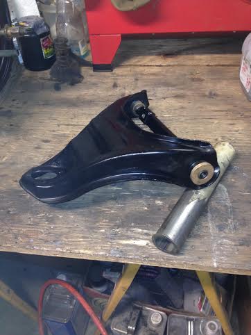

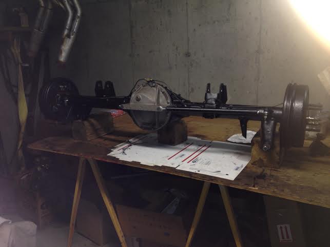

Here is the completed rear- 4:88's Moser 33 pline spool with rifle drilled axles, "star" flanges, also rear upper control arms, $30 each to builld in parts, not a "dime rocket" but the last time i had someone else fabricate them for my 68 they were $400- don't have that $ now! Also my "poor boy" solid front upper control arm brass bushings. Chucked up on a lathe years ago machined to fit my control arms. Donated brass- total cost $0 Car is wrapped up outside from snow, frame is attached now.
Will Lamprecht 65 Impala 396/325 I/SA in progress

Is that a brace in that location? If so, how dose the panhard bar attach,and work? I had to modify one just to clear that type of cover.Thanks.
