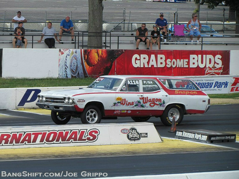

Mike Jones
Join Date: Apr 2012
Location: Connecticut
Posts: 1,125
Likes: 1,179
Liked 684 Times in 289 Posts
Default Re: New member starting a P/SA project Fairlane this winter
Welcome to P/SA Jim!
I campaigned this 69 Chevelle in P at Division 1 races in 2012
Had a blast
met a lot of fine people, helped me any way they could
and believe me, I needed help
Don`t need roll bar, driving suit or updated lap belt
I paid $139 for a SA2010 helmet, and I was good to go.
That was last year, so check the rule book
all the best to you, Jim
Mike Jones
A114 P/SA
