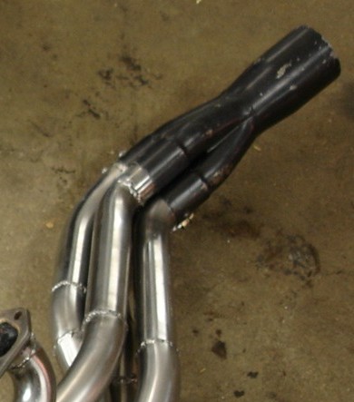

The header tubes can finally merge together, under the frame, at about a 30 degree angle back from straight out the sides, approximately 12" from the outside of the car.
A merge collector piece such as this one that I just used on headers that I built for a customer car.... would actually exit out from under the front fender, extending about 6" outside the car !
Can't be done.
