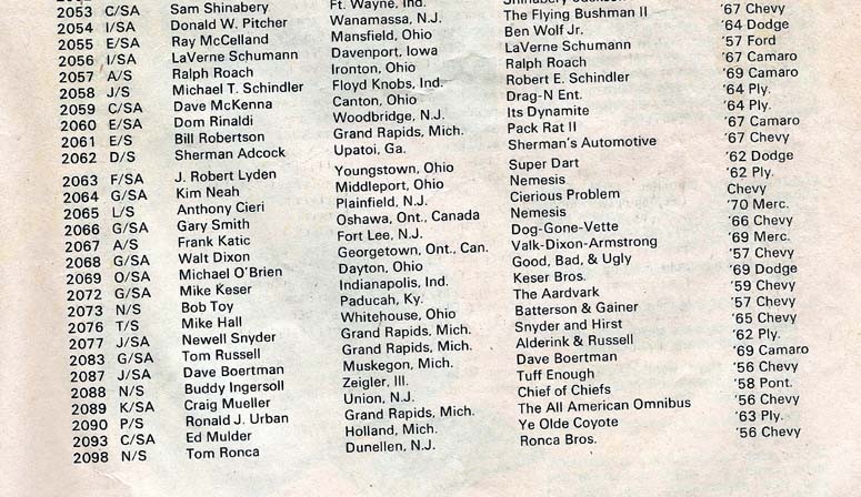

Back to Ben Wolf, Spring 69 B/SA=8.00 class, the "1961 Pontiac".
Here's part of the entry list for 1970 Indy. Note McClelland & Wolf entry, a 64 Dodge in E/SA=9.00 class. Different class, so it's likely a wagon, 426/415hp max wedge.
But the point is, it looks here like they defected to the Dark Side (LOL) from Pontiac in 1970 Indy.
Did Ben Wolf move over in Spring 69 with a B/SA=8.00 2dr sedan Dodge 426/415hp? We dont know, but
1. The car fits
2. There's now evidence that Wolf & McClelland moved to Dodge by 1970.
Did they ever run Pontiacs again?
The last time I have Wolf in a Pontiac is 1968, and McClelland in 1969.
The B/SA=8.00 Ben Wolf mystery lives on. Maybe forever LOL.
