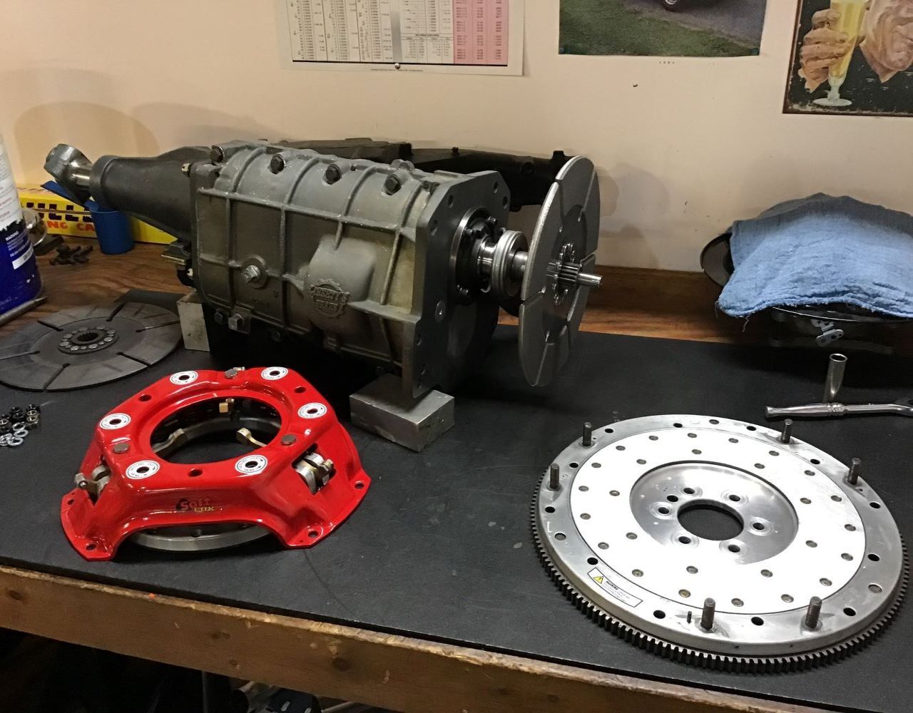

[IMG]clutch[/IMG]

Liked 805 Times in 245 Posts
Default Re: manual trans and clutch quaetion
Originally Posted by joespanova View Post
[IMG]clutch[/IMG]
Really hard to argue with a basic Softlock and alum flywheel. It's more about properly tuning these type of generally available components than spending money on snake oil.
I 60ft between a 1.26- 1.30 most of the time @ 3000 lbs. I also beat it up pretty good. This was my first rebuild in years.
