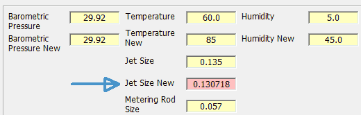

John,
The jet is fixed at 0.135" or 0.014313881527918496 sq inches of flow area.
A 0.057" rod has an area of 0.0025517586328783095 sq inches
A 0.066' rod has an area of 0.0034211943997592849 sq inches
► 0.014313881527918496 - 0.0025517586328783095 = 0.011762122895040186 Total Flow Area
► 0.014313881527918496 - 0.0034211943997592849 = 0.010892687128159211 Total Flow Area
The metering rod is much smaller that the jet and so a large change in metering rod area has much less effect on total flow area.
► 0.010892687128159211 / 0.011762122895040186 = 0.92608173076923073 change.
I tried not to post to much math the first time as in other forum the math scares some people.
Stan
PS - Let me add that if they could change jets and keep rod the same size like you can on the Carters. Same weather as picture on previous page.
