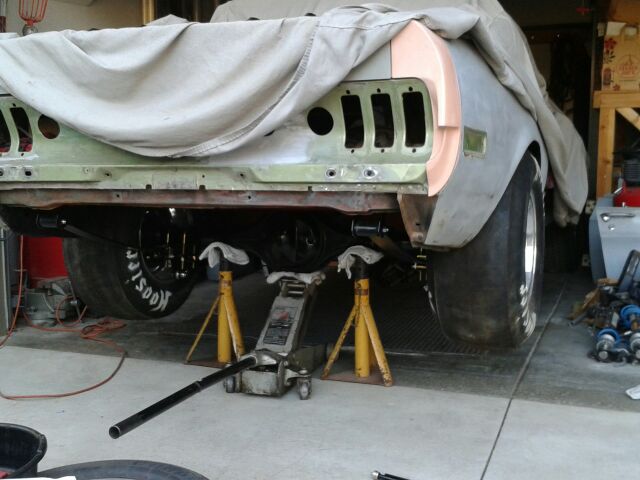

My Shelby stocker project has 9"x29" bias on 10" wheels with 5.5 backspace.
Just needed a little massage from a BFH in the front inside corners and some fender lip work.
Also the Cal-Trac leaf springs were a little narrower than stock.
Name:	wheel opening.jpg
