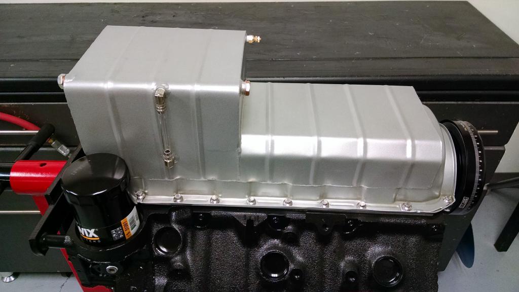

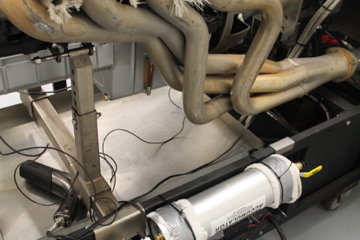

Originally Posted by Adger Smith View Post
Try it on the dyno..
Cut up a pan and put a sight panel in it.
I tried it with a sight level tube on the outside of the pan on both sides, first..
Scared me how low you could go in a static position.
SS/Div6 that return to the sump by the bypass should cut down on the aeration of the oil coming out the bypass.
That is a huge benefit in lubrication. Air bubbles don't cool or lubricate.
I've done this. My question is does the engine make more power with less oil, or on the verge just enough oil, I I'am down 1 mph with no signs of windage problems with an extra 2 quarts in the system.
Name:	oil sight.jpg
ID:	51539   Click image for larger version
Name:	oil pan testing.jpg

I didn't think you could run a modified pan or accumulator in stock.. Correct me if I am wrong on this.
Thanks
Thanks
You can run an accumulator,and NHRA has a list of accepted pans you can use.. gsa612
Is that the pan you run in Stock? Do you log oil temperature?
Pretty sure that's a Chevy pan, and we're talking about a Buick here. ;-)
That's a Chevy pan on a Chevy engine,with the filter in the back.Buick filter is in the front,and the pan mounting is completely different. gsa612
