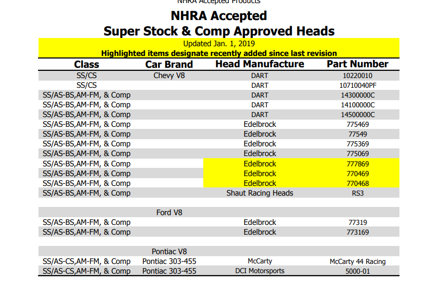

SS/CS is cast iron in line valve heads only. Aftermarket heads need to be on the NHRA Accepted Product List. GM and Pontiac are listed separately so I don't know if you can run Pontiac heads on a Chevy. The national record holder in CS is a 302 Ford running NASCAR iron short track heads. They aren't listed but have a factory part number.
Aftermarket aluminum heads, inline or canted, are allowed in SS/BS. Watch out for the Hancock and Lane car from D6 if you build this.

The Pontiac heads were made for the small block Chevy and are legal in Modified. I use the Buick head on a small block Chevy which is legal in SS Modified

Can run SS/BS with either cylinder head, or run SS/AS with the SB2.2.
Can also run SS/AM thru SS/FM with both heads.
Canted valve allowed also in SS/AM and SS/BM.
SB2.2 is a splayed valved head, not canted.

SB2 valve angles are 12° x 4° Intake and 8° x 0° Exhaust and considered Canted.
The SB2.2 valve angles are 11° x 4° Intake and 8° x 0° Exhaust and considered Splayed with all the intake ports pointing towards the center of the cylinder head.
The 8° Exhaust valve angles towards the intake manifold just like a normal wedge cylinder head.
