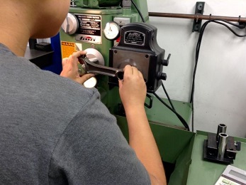

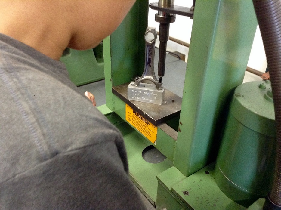

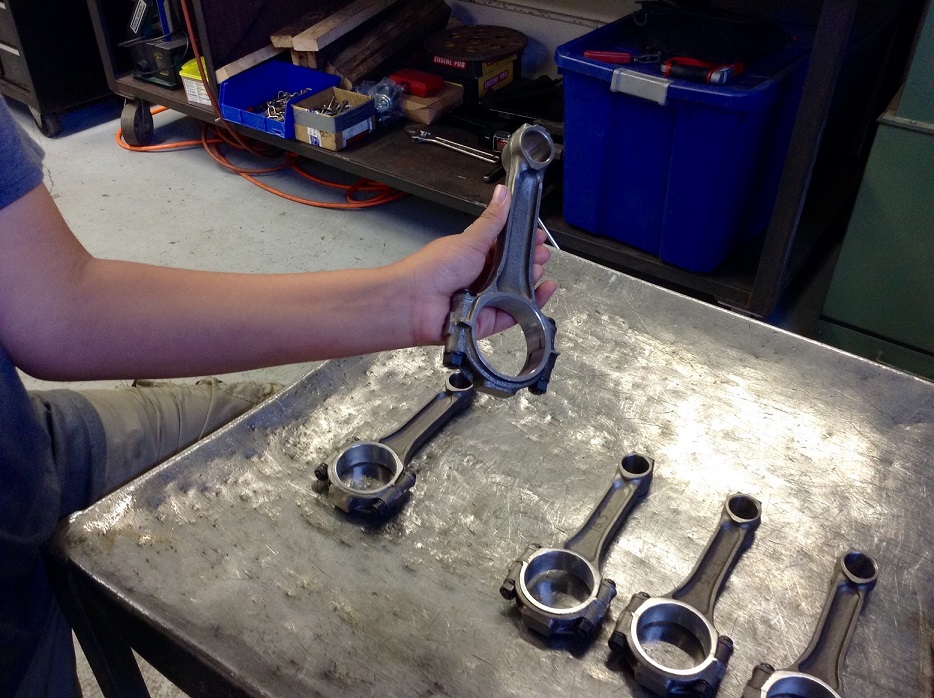

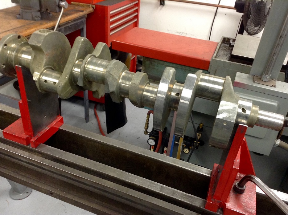

Pictures of rods. I will balance them next.

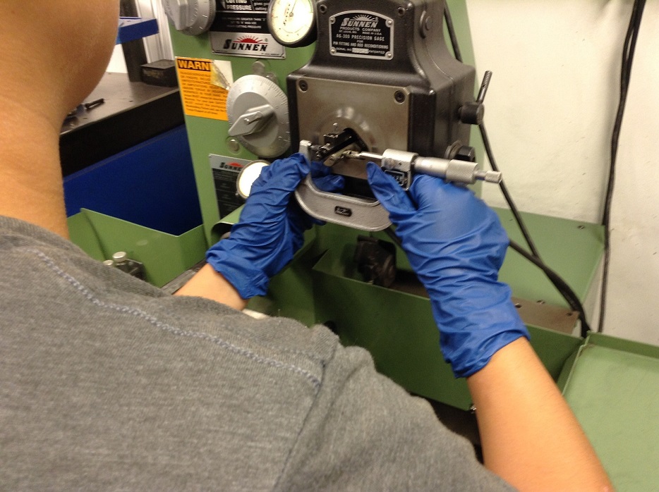

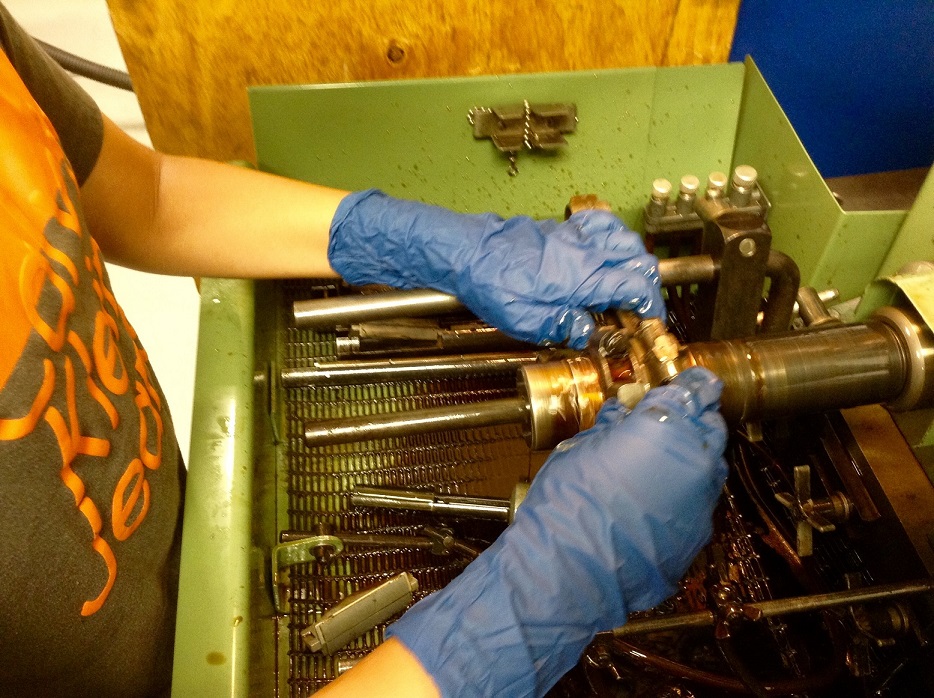

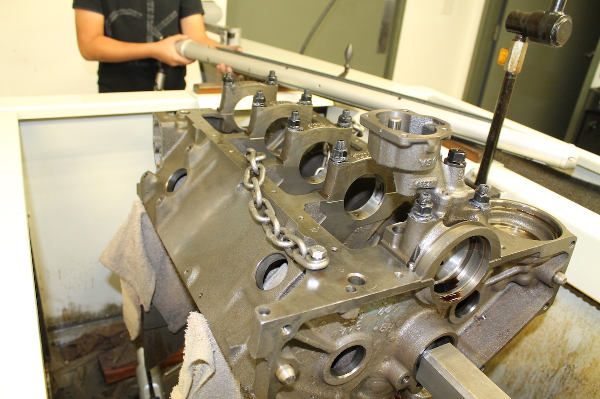

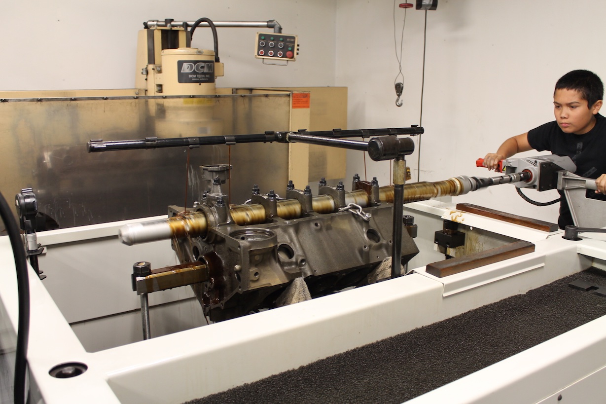

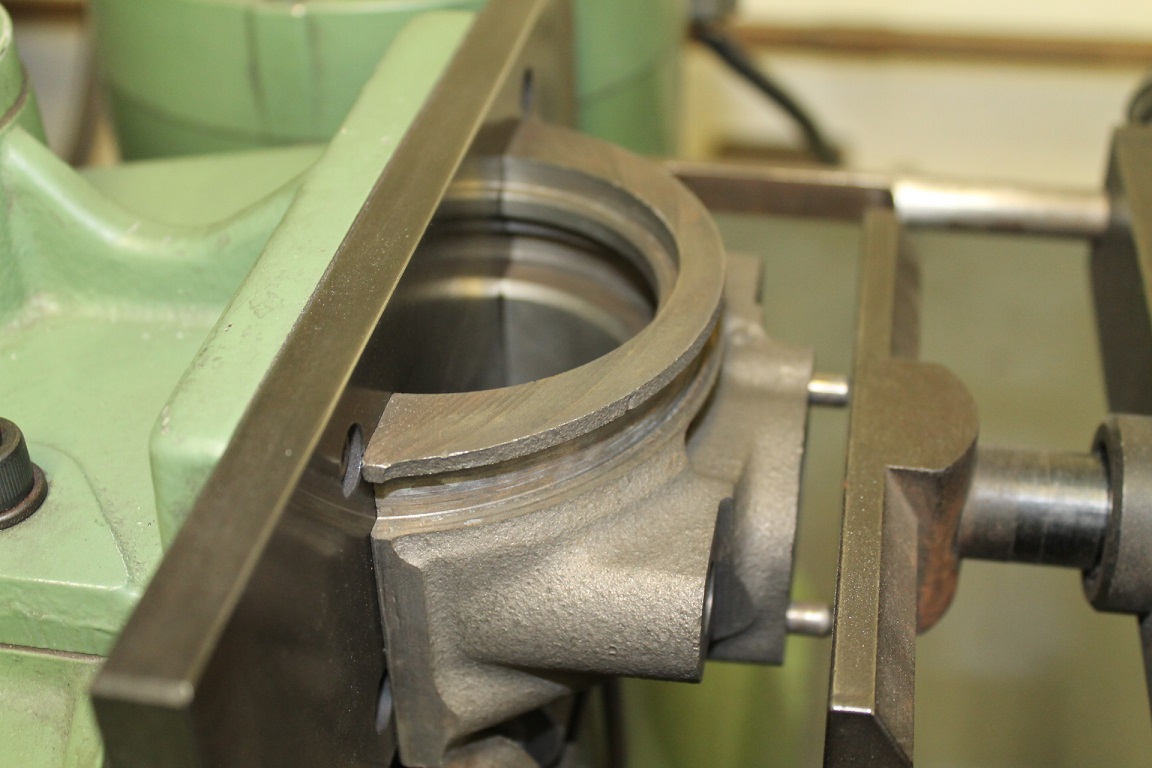

Setting up for the line hone.

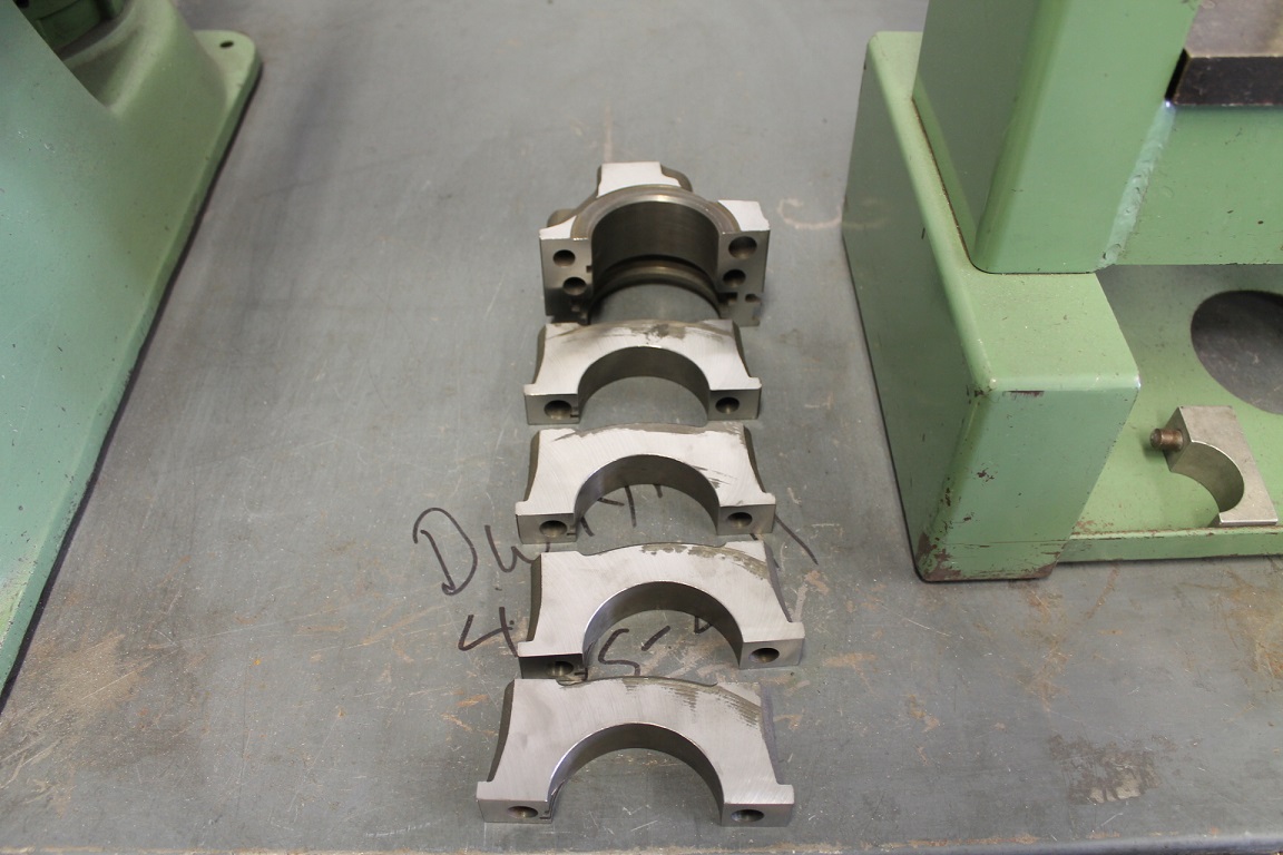

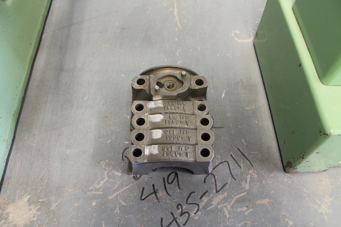

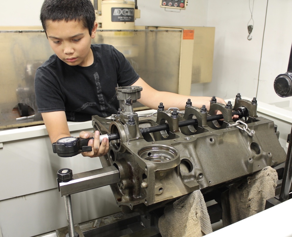

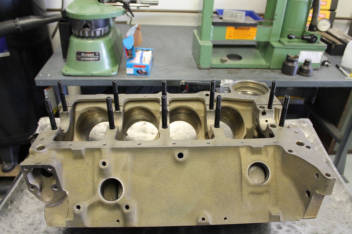

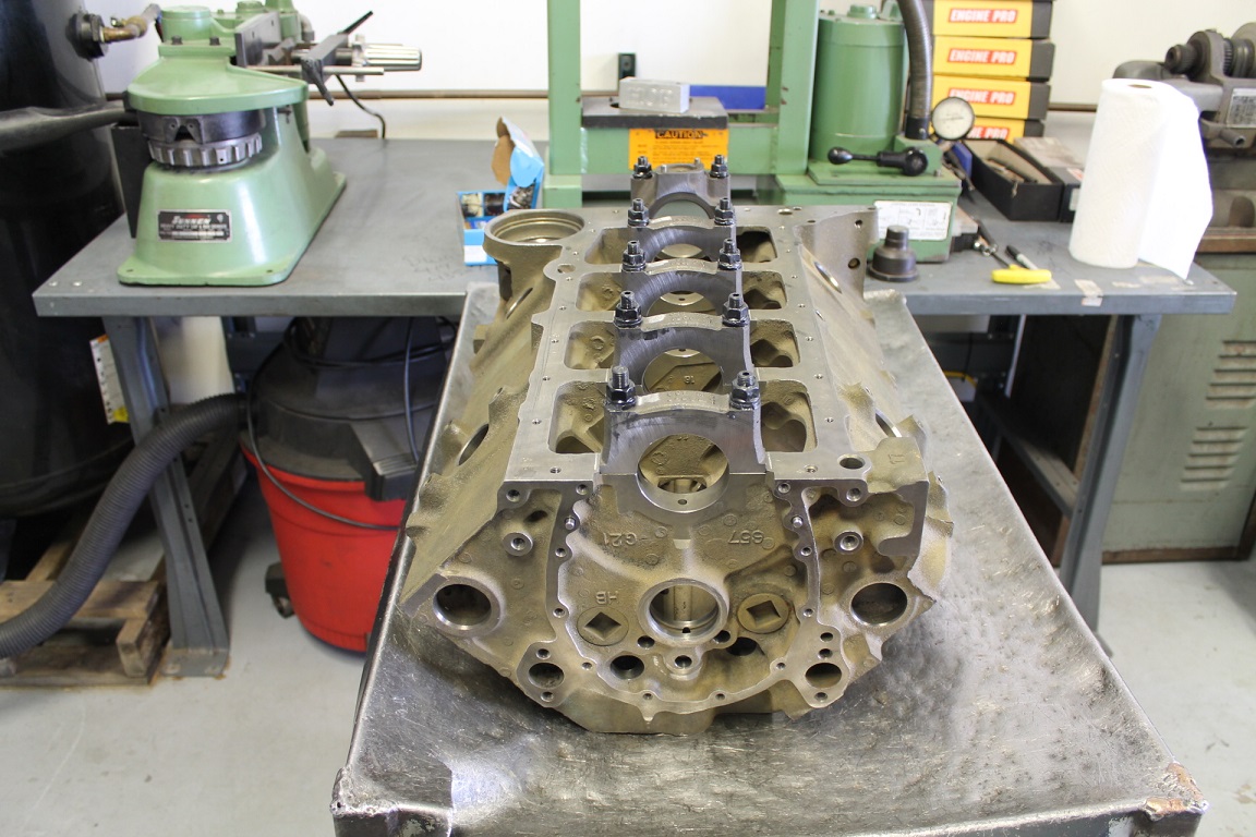

Today I finished my line hone, set housing bore to 2.4914. Next I will clean the block and set up for decking, assembly height:
Stroke 3.00
Rod length 5.698
Comp height. 1.800
Total height. 8.998
I need to decide which head gasket thickness I will use, then I will cut the block.

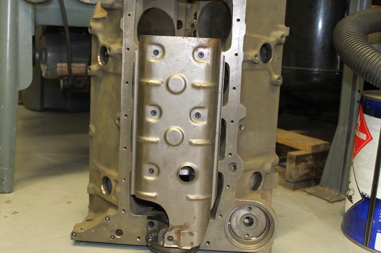

Thanks! A member on here donated this 1967 small journal Z/28 windage tray, which was very appreciated, very hard to find piece. I will clean it and punch the holes out.
