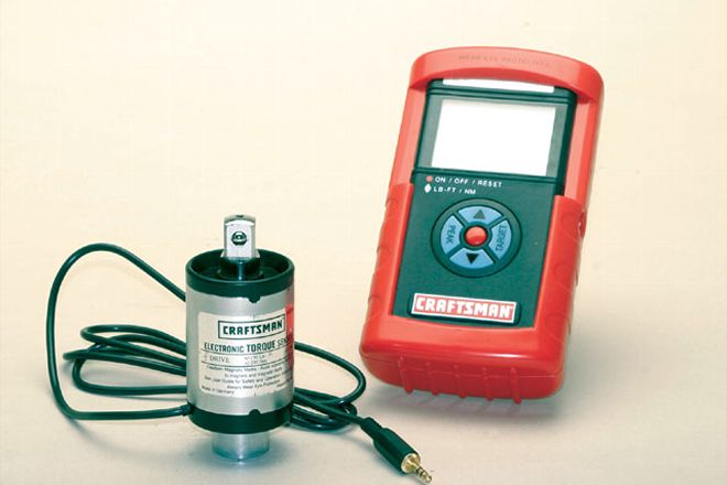

CDI is one of the major torque wrench manufacturers and they make the torque wrenches for Snap-On.
http://www.cditorque.com/
Still, my preference for accuracy is my old Sears Craftsman Electronic Rotary Torque Meter that was discontinued many years ago.
Had it checked many times for accuracy and right on spot.
It measures ft/lbs, metric and torque angle.
