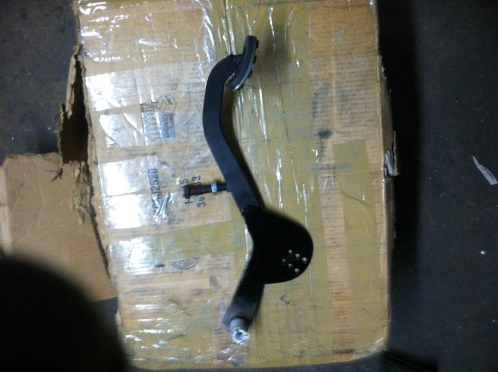

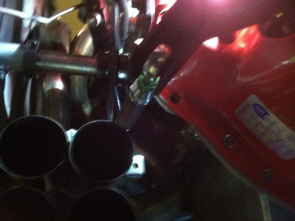

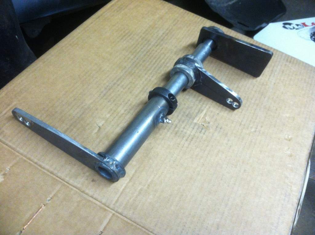

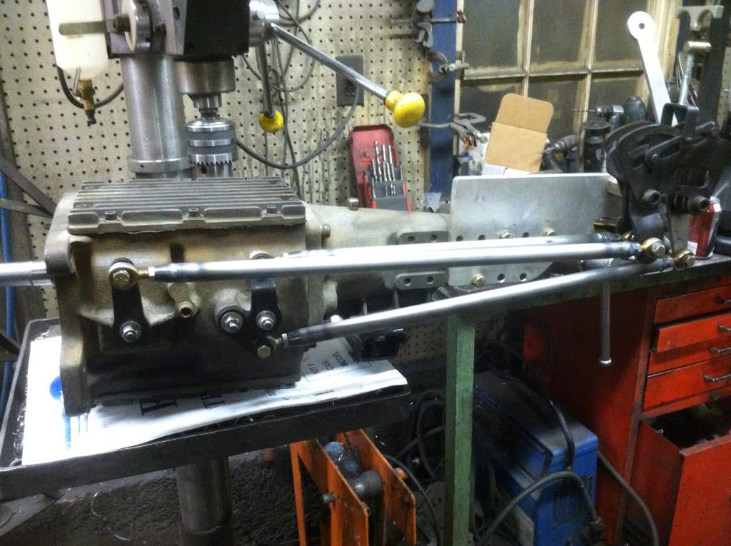

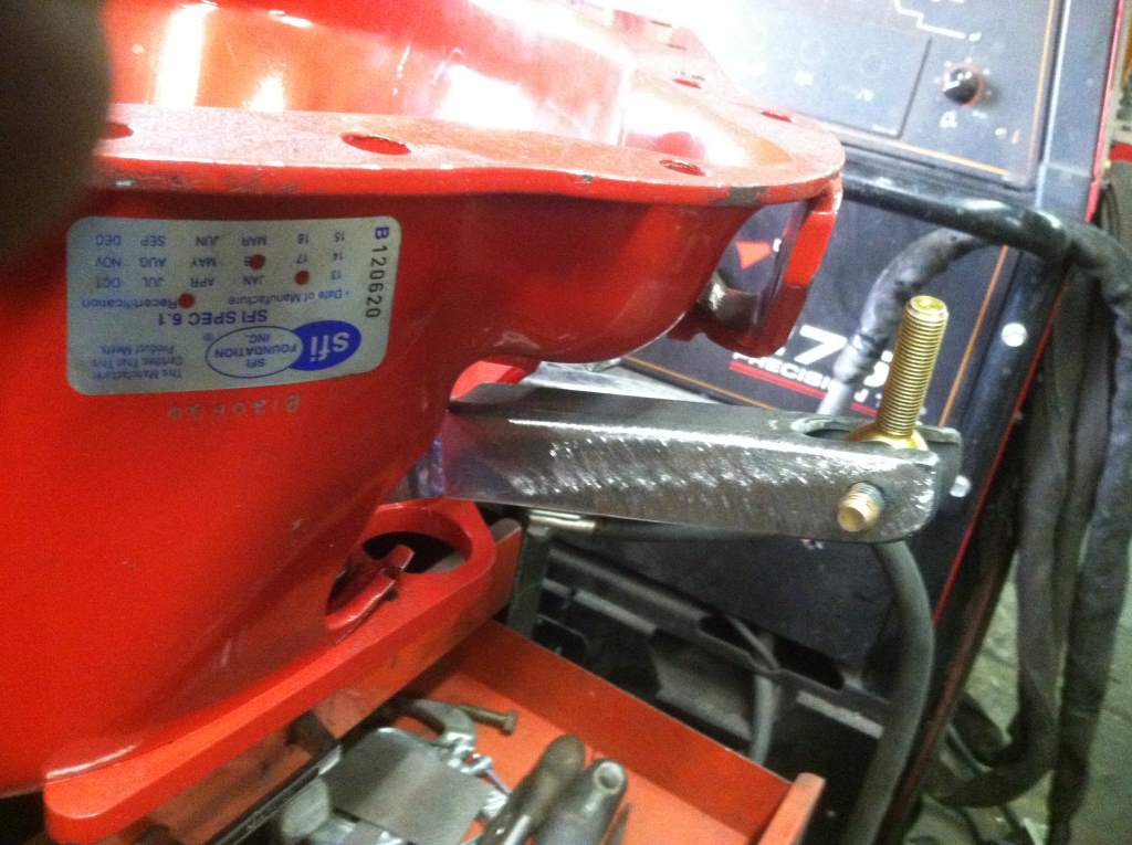

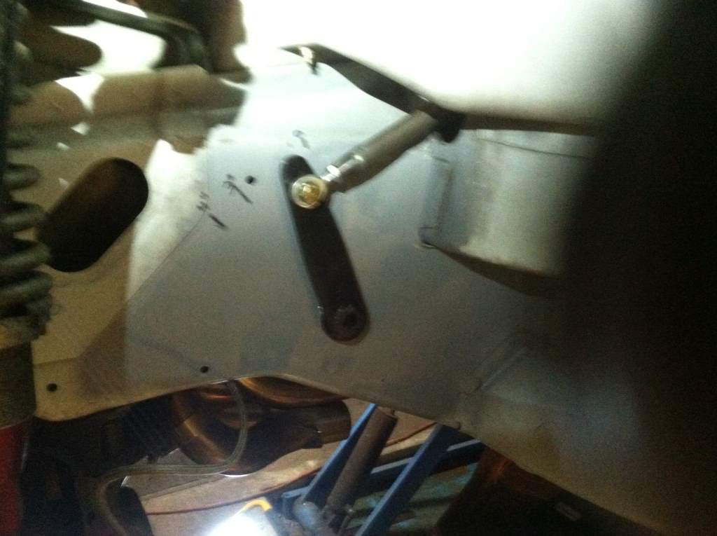

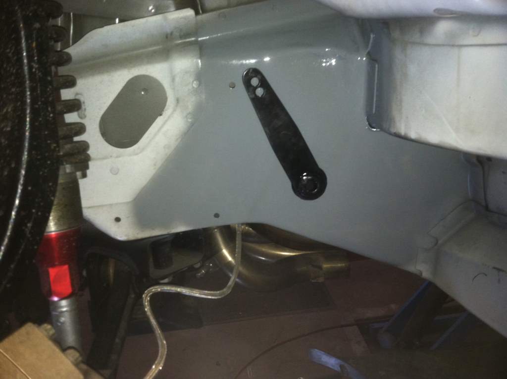

Originally Posted by JMan View Post
Hey Tom,
Would you consider selling me a Z-Bar for my Drag Pak? That would save me a bunch of time in design work.
Sorry for not responding sooner ,got a lot going on.
I really didn't make any final patterns of the clutch setup since it was refined over a few weeks of building.
Here are a few pictures to give you an idea of how I did Eric's DragPak.
The sleeve is bushed and is welded thru the frame rail and the supported at the bellhousing .
I'm looking for a better picture of the bellhousing end .
You will have to fabricate a custom shifter mount and longer linkages.
The left side of the tunnel will also need work to clear the linkage .
.[/QUOTE]
Thanks Tom. I appreciate the pictures and description.
I could tell before that it's going to be complicated to switch to mechanical linkage...and it is.
Definitely not a "bolt it" operation.
Happy New Year!

Originally Posted by Plymouth1969 View Post
Is that a stock small block layout bellhousing on the dragpack?
It is a stock SBM (LA) bolt and dowel arrangement, but you can get a bellhousing with left or right starter locations. Right side starter helps with steering shaft clearance.
Im more worried about the fork location, i dont have my headers at the moment. Is the fork ok in stock location
Plymouth1969 is offline   Reply With Quote
I made a custom fork using the inner part of the stock type fork for the one I built .
The basic location is ok. ....Just needs a little more length and a straighter line out of the bell and I prefer to have a direct link instead of a push pin.
These are MR2 Race Cars headers for the DragPak 360 shown in my previous pictures

great pictures. did you make the shifter aluminum mounting plate? I want to beef up
mind.
stock1080 is offline   Reply With Quote
Old 01-02-2018, 09:42 AM   #20
Tom Goldman
Tom Goldman's Avatar
Join Date: Jan 2003
Location: Allentown,PA
Posts: 2,477
Likes: 892
Liked 883 Times in 237 Posts
Default Re: Hydraulic Thow out bearing
mind.
Yes , 1/2" T6 . The picture was taken before I did the final trimming in front of the shifter . .... You don't realize how far back the driver placement is until you see stuff like the shifter.
