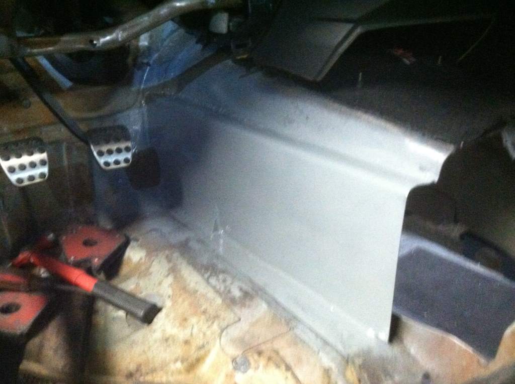

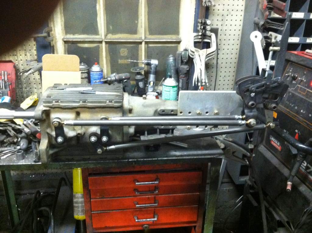

Regardless of which transmission you choose ,be prepared to make a major modification to the left side of the tunnel for the shifter and linkage .
You will also need to fabricate substantially longer linkage and shifter mounting bracket .
Depending on your choice of bellhousing you may need to clearance the large firewall reinforcement above it .
