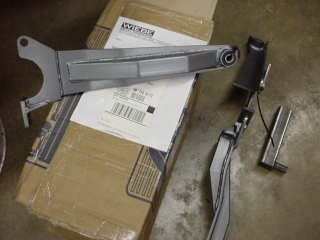

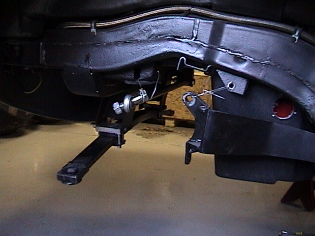

Old 12-20-2015, 08:36 PM   #16
Bob Pagano
Bob Pagano's Avatar
Join Date: Jun 2002
Posts: 1,163
Likes: 248
Liked 16 Times in 11 Posts
Default Re: C2 corvette Stocker question
9x30 fits, you need to get dirty, more than one way to do it. Pictures are of Weibe trailing arms witch he dose not make anymore.
ID:	31907   Click image for larger version
Bob Pagano A/SA
Old 12-21-2015, 12:43 PM   #17
Eman
Join Date: May 2014
Location: E TN
Posts: 474
Likes: 16
Liked 133 Times in 76 Posts
OK, from the pic I see you use a panhard bar at the top for a locator. Years back I destroyed a lot of half shafts and stub axles.
Eman is offline   Reply With Quote

Old 12-22-2015, 12:38 PM   #20
bigsixman
Join Date: Sep 2012
Location: Crookston, MN
Posts: 157
Liked 2 Times in 2 Posts
Does anyone have pictures of the Alf Wiebe corvette trailing arm rear suspension system installed in a corvette? I would sure like to see some good close up photos of that complete suspension in a corvette.
Thanks in advance.
