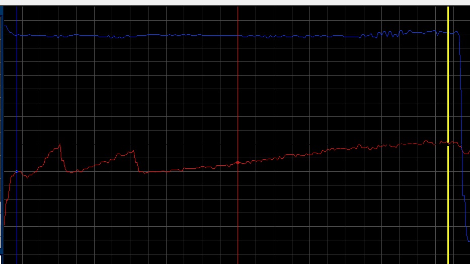

Here is a zoomed graph of RPM (red) and MAP (blue) and you can see at the end there are some gaps in the red RPM line and the MAP also senses the blips. I don't think this is valve float but I don't entirely know what that looks like on a graph.

Bobby, it's a bit hard for me to see (maybe my screen resolution) but it looks like your MAP starts to really jump just as your RPM trace begins to show gaps. I've never seen a trace where there is an actual gap in it before. However that may be a clue, as an engine misfire will effect the MAP reading, how bout you contact the manufacturer of your data logger and run it by them. This is only my opinion but since the trace has a gap does that indicate there was NO RPM signal recieved? Also does your tach in the car indicate similar issues? Such as jumps or bounces?
