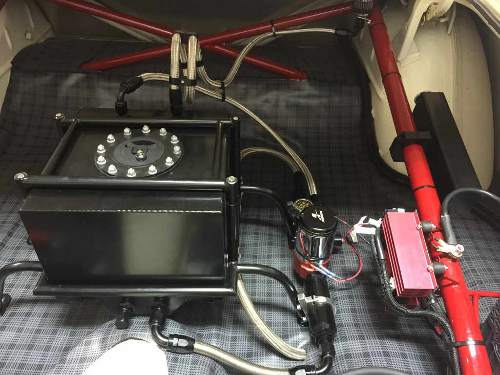

Cool Re: Failing Fuel Pumps
This is the Fairlane fuel system.......the fuel pump has been lowered since this photo and after the first pump failure. I have Aeromotive 4 port Pro-Stock regulator, dual 4 barrels with side hung bowls, 6.5psi. My major concern is I built my hemi car fuel system the same.....using the same pump.

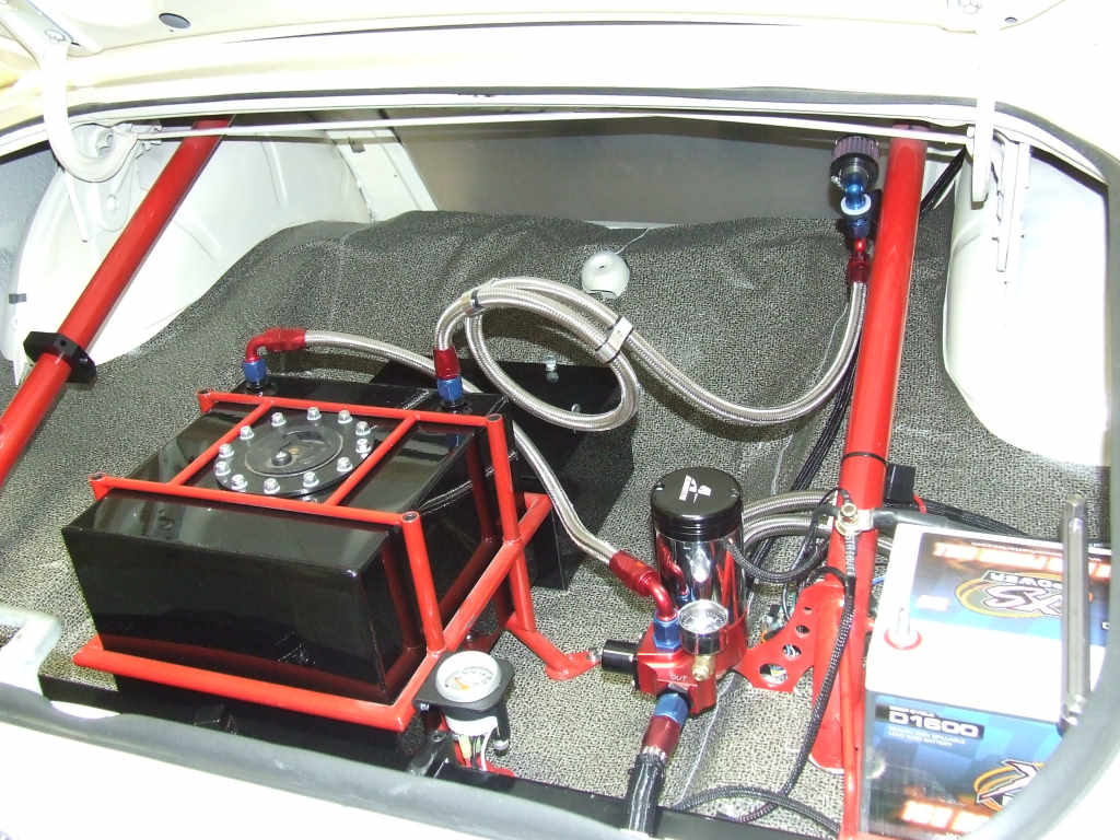

Hemi car fuel system photo.

Default Re: Failing Fuel Pumps
Tom,
That's a very nice neat installation. I am envious. The only issue I can see is the loop in the vent line. I would get rid of the loop. If you get any liquid in that loop it will act as a trap and wont let the system vent. Looks lie the vent in the hemi car is straight.
Mike Pearson 2485 SS
Old 03-26-2015, 11:59 AM   #15
Tom Nolan
Location: Lacombe, Alberta, Canada
Posts: 182
Liked 64 Times in 11 Posts
Ok thanks, good advise, I raised the filter as high as I can and took out loop on the hemi car and will do the same with the Tbolt.
On my car I ran the vent down through the trunk floor using a bulkhead type fitting. The filter might also be slowing the vent process especially if the filter media gets wet from fuel. You might thing about ditching the filter as well. I think by the rule the vent is supposed to be plumbed to the exterior of the vehicle. I would check the rulebook on that too. Hope it helps to fix your problem.

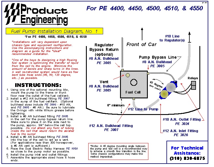

Old 03-26-2015, 01:32 PM   #19
SSDiv6
Join Date: Feb 2003
Location: Glendale, Arizona
Posts: 3,044
Likes: 712
Liked 1,585 Times in 582 Posts
Tom,
I have seen your car run and I know you do not have a fuel delivery problem.
If you fuel cell was not venting and the fuel filter causing an issue, you would have seen it affect the performance of the car, especially on a high horsepower car like yours.
Your fuel pump is installed like many other racing pumps.
Name:	Pump Install.jpg
