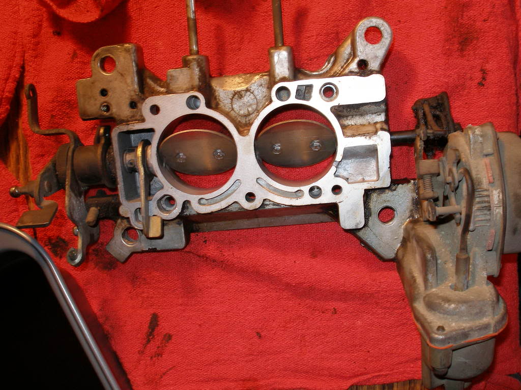

Old 04-17-2014, 09:38 PM   #17
Posts: 7,818
Likes: 2,909
Liked 5,126 Times in 1,954 Posts
Default Re: Ford 7200 vv carb.
1, 2>>>
