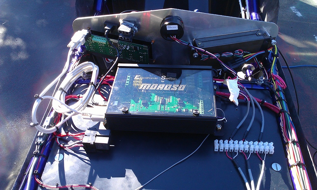

The Moroso Electronic Switch Panel (ESP) is pretty cool. It has a panel mount or roll bar mount switch board that connects to a main controller. The switches have lights on them that can be dimmed.
It is really powerful. It can turn your water pump and fan on/off based on engine temperature. It can also time out stuff in your car (so you don't have to worry about leaving stuff on after a run). It has warning lights too to let you know when oil pressure is low or a system in your car is failing. Definitely worth checking out. I don't think it is priced too much more than a K&R Switch. Portatree helped developed it and we run them in both of our stockers.
