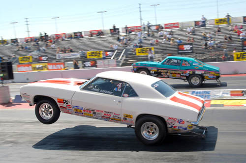

I tell you what you show me a stocker 375 that makes power above 7000 -7100 . Jim
How about a pair of them.
