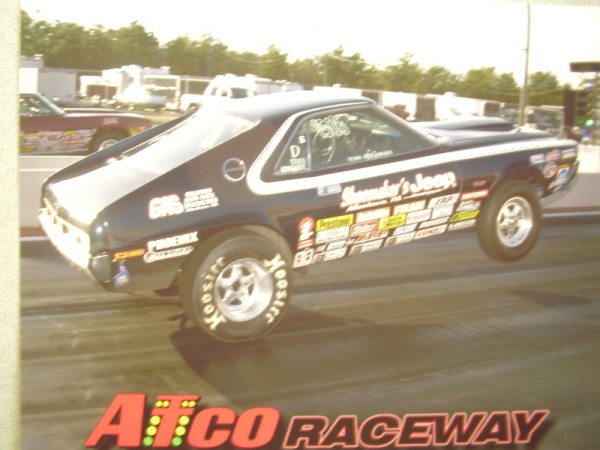

Big wheelies from an AMX are not only expected,they are mandatory!!
AFCO can make shocks fit just about any application to control the wheelstand.
The Keir wheelie bar is great on an AMX as long as its not too low and has a fuel cell.
After 30+ years in 100" and under wheelbase cars, I have to agree with Jeff, nothing beats a "blue sky" ride !
