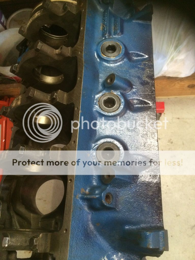

That is correct, and the reason I am doing it is because the class requires factory motor mounts, if he looks close at the pic the motor mount bolt bosses are right next to the core (freeze) plug holes, with no support at all. the "idea" is that the screw in plugs will spread the load across the block casting more evenly....without it the ring seal would suffer. Those that race factory ford castings know the history of fords "thin wall' casting technology. This area is often overlooked. The engineers at ford installed screw in plugs on the original boss 302 and others for this very reason.
A motor plate would solve this but as the rule is written they are not allowed at this time
Rick, I will get a better pic to show you what I mean

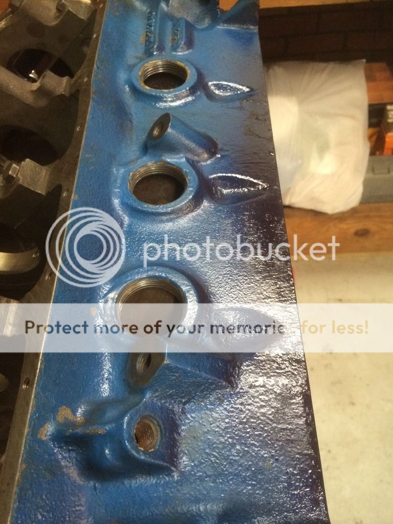

Old 02-18-2017, 08:45 PM   #153
Bill Diehl
Bill Diehl's Avatar
Join Date: Dec 2013
Posts: 311
Liked 9 Times in 8 Posts
Default Re: Boss Mustang stocker
This photo shows the location of the core plugs vs motor mount bosses. There are 3 on each bank and the motor mounts intersect the first 2. Most other manufactures don't have this problem. The main reason is ring seal but what the NHRA should be concerned about is the soft plug coming loose on the 1-2 shift or 3-4 ect. I would not like it nor would the car in the other lane. screw in plugs solves that concern.
Bill Diehl B200 C/D STK
Got it. Now I see what you are talking about. Makes sense. Thanks for clarifying for me.

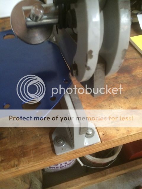

Old 02-19-2017, 11:11 AM   #156
Bill Diehl
Bill Diehl's Avatar
Join Date: Dec 2013
Posts: 311

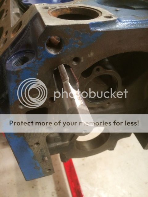

Cleaning up the front of the engine...since I will be using an electric water pump some mods to the front so I don't need a backing plate in this series.
cut the top bolt hole off that sticks up into no mans land, tap the water recirculation hole, makes for a nice clean d shaped installation

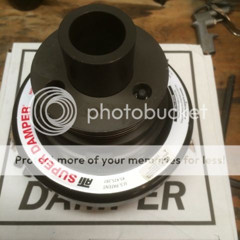

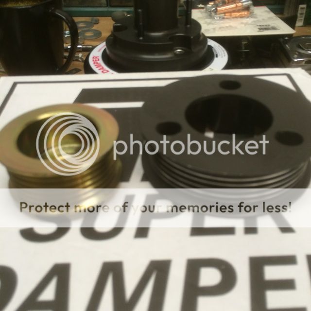

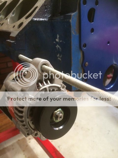

Old 02-19-2017, 11:25 AM   #157
Bill Diehl
Bill Diehl's Avatar
Join Date: Dec 2013
Posts: 311

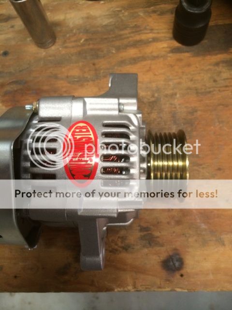

Converting to a low mount mini alternator, the stock location mounts off the head, uses too long of a belt, sticks out too far and just looks like...you know the word. So I will use a billet aluminum mandrel with a provision to run a vaccum pump at non NHRA races, and I will run a serpentine short belt with the correct ratio..no belts thrown off, no dead battery..ect..mocking it up to fab the brackets in this series

Old 02-19-2017, 12:18 PM   #158
Bill Diehl
Bill Diehl's Avatar
Join Date: Dec 2013
Posts: 311
That is an adjustable voltage alternator as I use a 16 volt system on everything I build

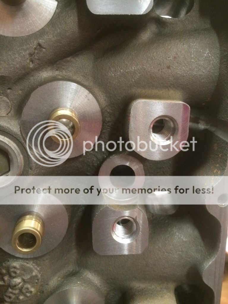

Old 02-19-2017, 01:00 PM   #159
Bill Diehl
Bill Diehl's Avatar
Join Date: Dec 2013
Posts: 311
A ford cleveland this is required...lifter bushings. it is the ONLY way to correct the oiling issue that this platform has. I have them made at 1.187 OD so I can correct the horrible geometry that the blocks are as cast...its amazing the engine even runs let alone makes any kind of serious power or rpm without it. my cams are ground accordingly and still use the fords .875 dia. lifter
and the lifter bushing work corresponds with the correct rocker stud location, inserts are installed to get the geometry "spot on"... 7/16 bottom thread relocated to the "right" position, 1/2 top thread comp cams stud made by arp 1/2" trunions installed in the 1.73 rockers at the "correct" pivot length for optimum geometry in this application. (the pictures show what was done but the "math" involved will stay in my brain for now, I may share that info at a later date) The Geometry that I refer to is on both sides of the stud, not only were the rocker tip contacts the valve, as that is only part of the "package"

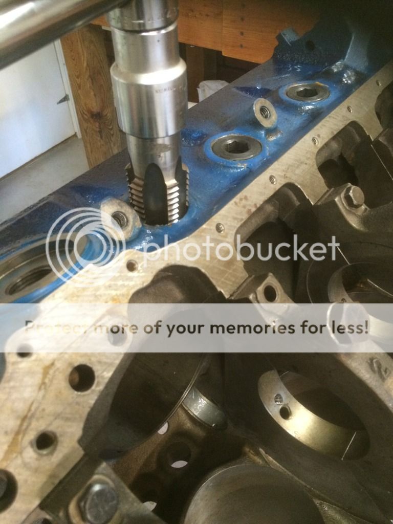

What a difference, every other thread removed and cuts through cast iron like butter by hand
Finished with 4140 alloy plugs
