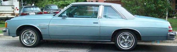

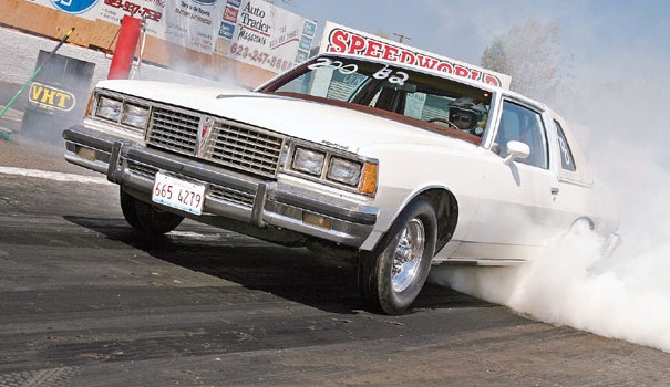

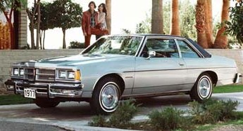

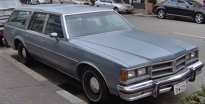

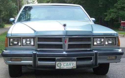

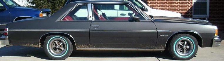

OK, the Catalina was the same size as the Bonnie, but had a different grill. They also had the same fastback roof line in the 2-door models. So, one of these will do just as good.
The '78's had a different grill than the '77's. I found a '78 on the track.
What do ya'll think would be the chances of finding one of these old cars in usable condition ?

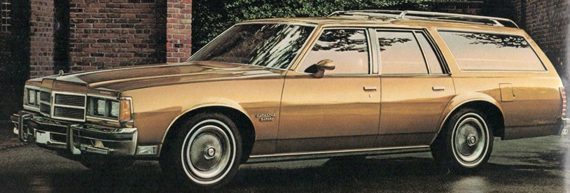

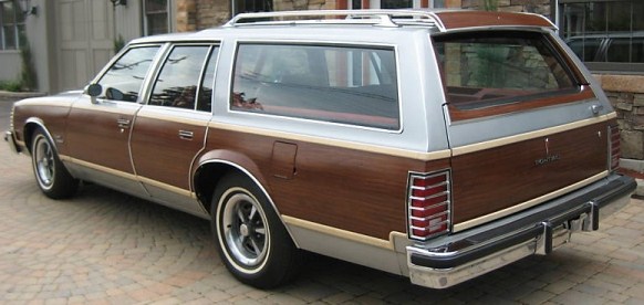

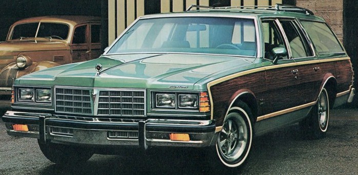

Then, of course to make N/SA @ 14.5 lbs/hp, would require a wagon or a GP SJ. But because of the lack of side vision, I've decided not to use a GP.
http://www.classracerinfo.com/Engine...spx?ENGINE=764
http://www.classracerinfo.com/NHRA_Classes.aspx

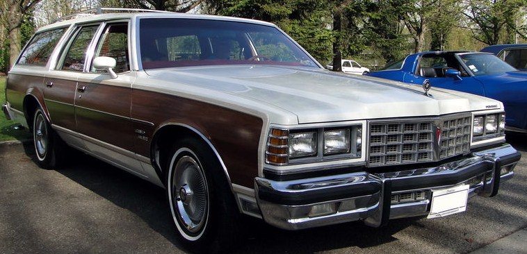

Either a Cat or a Grand Safari wagon would do nicely, and have PLENTY of side vision. Besides having more weight over the rear tires, the extra side vision is another advantage of using a wagon.
