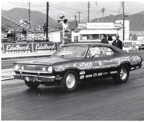

Default Re: Leaf,Lace,Scallops and Cobwebs.
These donuts or round circles sprayed on seemed to be popular back then...
