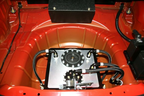

I looked at the 2020 rules online, didn't see anything about size, or bolts, other than 1/2" bolts for mounting to car. My weight box is a Ford Racing part, I have seen it on many CJ cars.

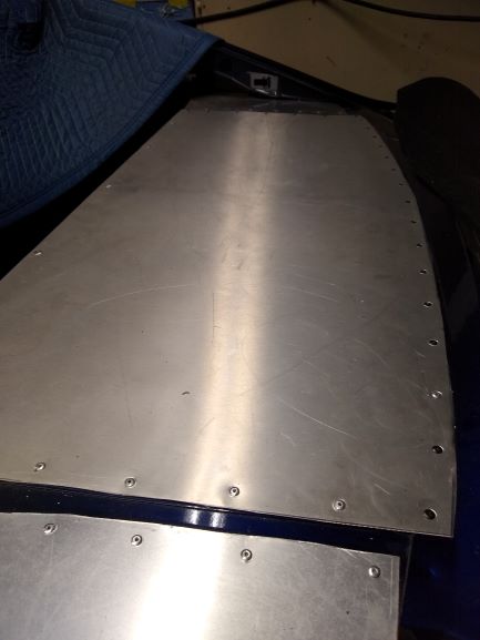

Covered up the package tray with some .032 aluminum, that finished the trunk, other than wiring. put the hood on and drilled for the hood pins. installed the bumper cover, upper and lower grilles. installed the snaps for my "Classic Coverall" from MJ Quinn @ Derby City Covers, and attached it to prevent damage while working under the hood.
