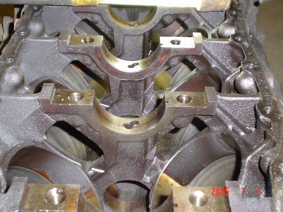

Also I was surprised when removing torque plate cylinders were. 0015 out of round up top. Bolted plate down again and checking cylinders were round again. It surprised me.
Normal for the the Oldsmobile 307 and 403 blocks.
They are of a lightweight design, light and have scalloped and windowed mains. For a full race engine, you can fill the block and used a girdle, or sleeve to a 307 bore size, a 1968 thru 1971 high nickel block.
Yes block was filled to bottom of water pump holes. Didn't know we could run a stud girdle. Ill look into that. Block was decked. We actually had to cut .034 to get zero deck. I have a 71 350 block but being a budget build I didn't want the expense of sleeving down to 307 bore
