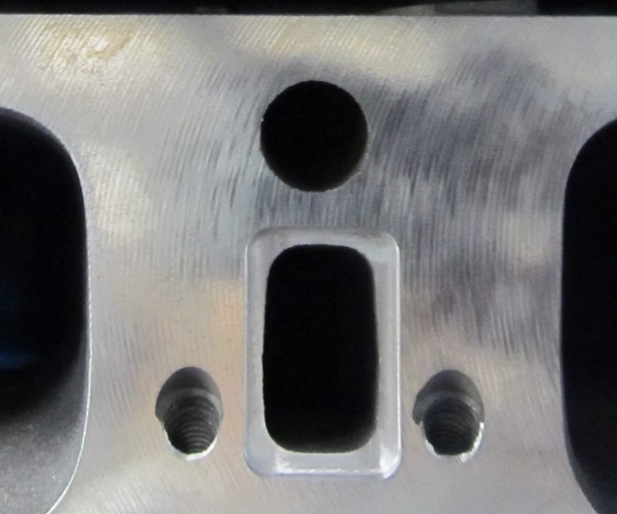

pushrod clearance....they start out as little round holes

Ummmmmm, that's an aluminum head in the pics you posted. You running SS ?

I think this is what it may look like it was posted on another sight as stock Dave.

That looks nice, thanks Sooner.

I think wer'e looking at a BOSS 351 '71 Mustang. Those might be Edelbrock heads part number 61607. They are listed as legal for both Stock and SS. They ship as bare heads and the buyer has to have all the machining done. That seems to be the case here.
