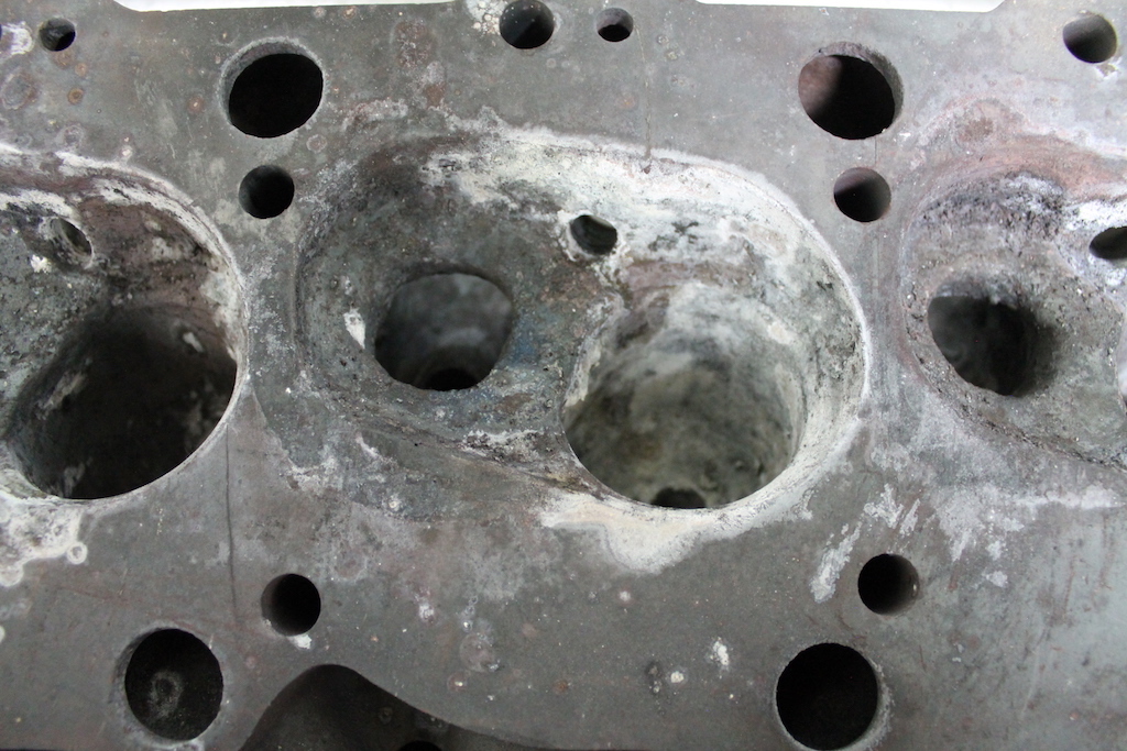

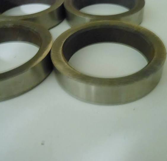

I will answer your question: My stocker combination also had .398 lift @ the valve. I dyno tested my engine as it came out of the car 474 HP @ 5400 RPM. I re rung the short block and turned my attention to the heads and intake. I focused on the .200 .300 .400 lift flow and made a nice gain. The engine went back on the dyno, I now had had 513 HP @ 5700-6000. In the real world that HP increase picked my car up exactly 3.2 MPH.
A BBC oval port head with either .398 or .460 lift @ the valve will require either welding the intake seat or Intake valve seats to do what your trying to do, as cast the bowl is too big for a 2.070 valve, which destroys low lift flow.
Example
There ya' go..Talk about sharing..Wow!
Hey Yac, what do you think it's gonna take to make THAT^^^ look "stock"?

Default Re: Cylinder head flow - What is crucial in a stocker?
Looks like a good start for Super Stock.
Well then you can say the welding is for Super Stock and the seats are for Stock.........theres more than one way to get there.
Special medicine..........
