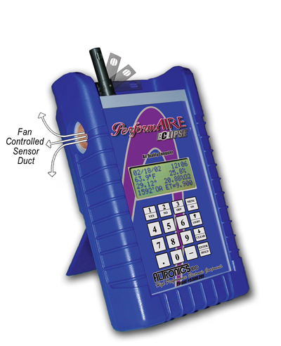

The PerformAIRE Eclipse is the only hand held that will work in direct sunlight.
Built in fan control allows unit to quickly auto stabilize weather readings and generate accurate predictions at you trailer or near the track.
Click on our banner for classracer discount!
Check it out on our website or give us a call for more info.
