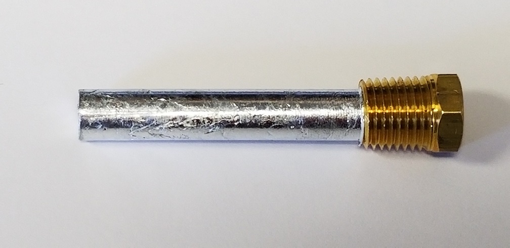

Lyn,here's one from Champion rad it screws into the water drain.Summit also sells them. gsa612
Name:	2in Anode.jpg
To protect aluminum the anode has to be more active than the aluminum, which would be a magnesium anode.
To protect iron you can use zinc as an anode.
To protect copper and brass, an aluminum anode will work,
Bob Mulry 7516 STK

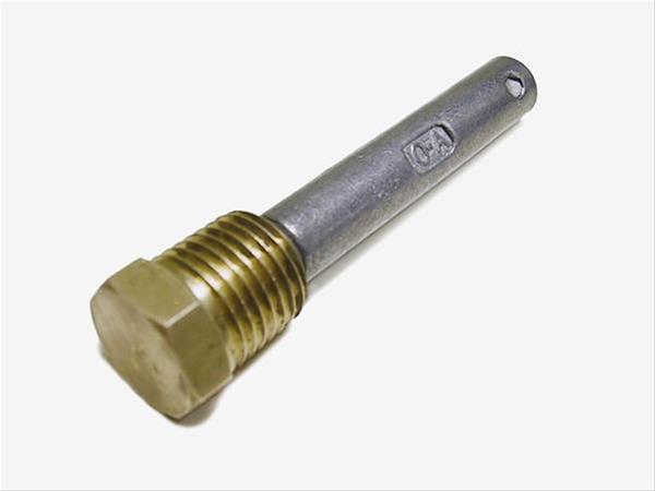

https://www.summitracing.com/parts/flx-32060/overview/

Originally Posted by Dave Sheehan View Post
That won't work..
He needs magnesium..
So with a iron block with aluminum heads and water pump I would want one magnesium anode and one zinc anode?
Thanks,
Bill
