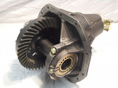

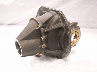

Old 07-01-2017, 06:56 PM   #16
SSDiv6
Join Date: Feb 2003
Location: Glendale, Arizona
Posts: 3,044
Likes: 712
Liked 1,582 Times in 582 Posts
Default Re: 8 3/4 Chrysler pro gears?
...and by the way...there is a drop out Dana 60 assembly available too!
http://www.jratoffroad.com/products/...od&productId=2
