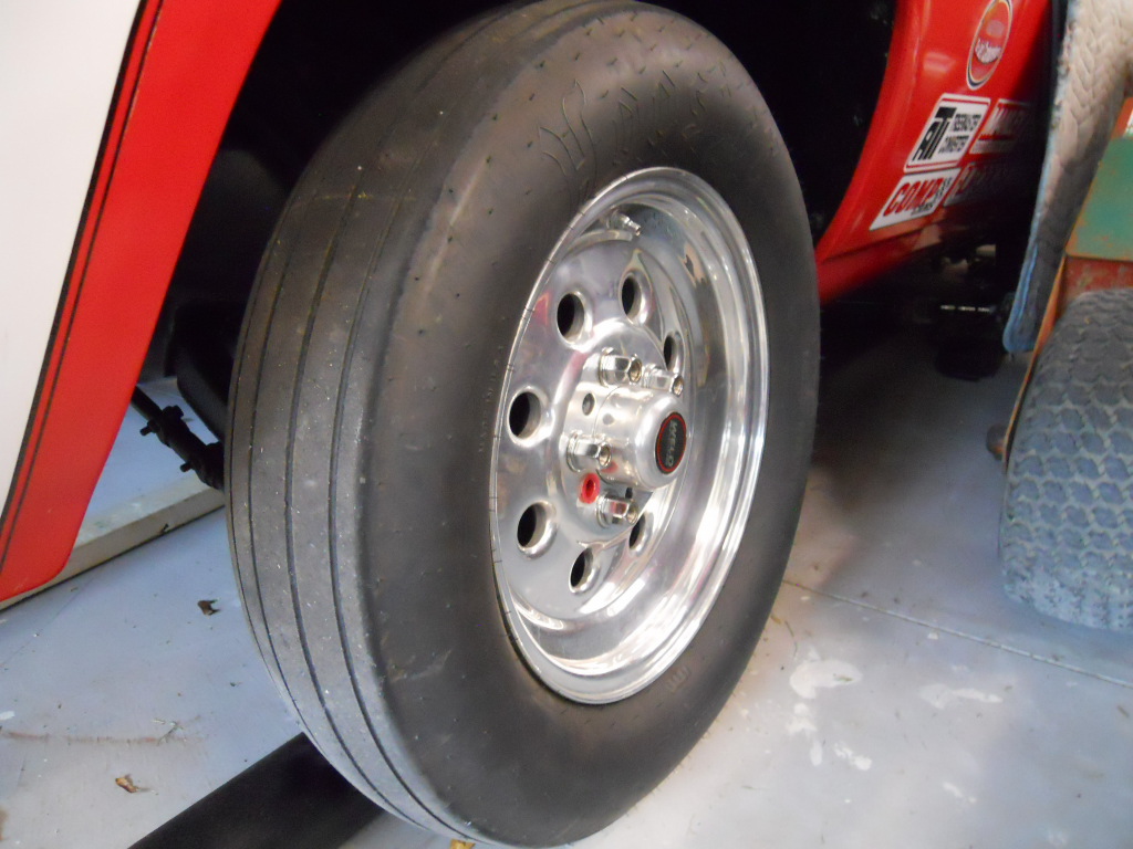

G/SA I wish I knew your name. Your example made me dig deeper. We use the same inner fender well (1971 and 1980 are the same). So it is essentially the same car. I removed the wheel and made a bunch of measurements. I thought I have a 3.5" wide wheel. It is 4.5" wheel. So if I buy a 3.5" wheel that moves the center of the wheel in 0.5" right there. On top of this my Weld Wheel is a 1 7/16" backspace, not 1.75" like I thought. So I think your 3.5" wheel with 1.75" backspace moves the tire in about 13/16". I think that works even on paper. Thanks for taking the time to reply and get me off my behind. Ray
By the way I use Strange brakes. The rotors space the wheel out about 1/4"

Sent wrong picture. This is the right one. Ray
