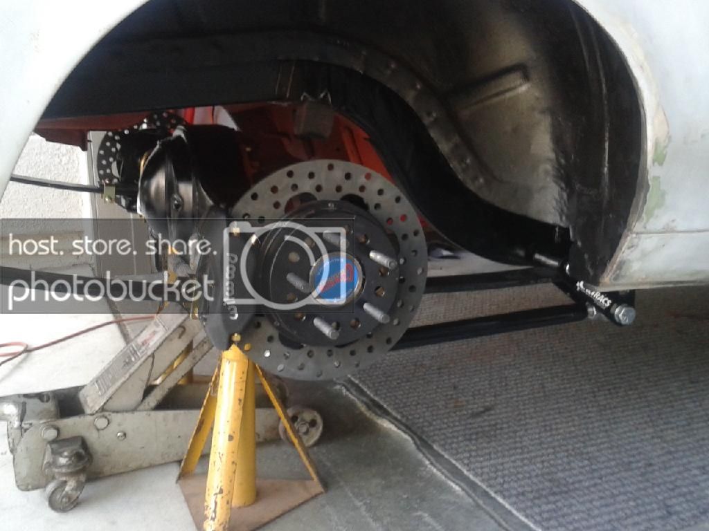

My car is a 71 Cougar. Not the same as an earlier Fairlane but close. Mine has 10" wheels w/6.5" backspace. I used a big sledge hammer on the wheel tubs, just trimmed on the inner fender, cut the legal 2" from the leading fender edges and took a 3 foot long straight edge under the car with jack stands under the rear end housing. I took a bunch of measurements and drew out what those looked like on paper, checked slick manufacturers specs O.D. and section width of the tire , transferred those measurements to my cars wheelwells and ordered the wheels that made that tire fit.
I wouldn't bow the fenders outer lines, IMHO. Just going to a 9x29.5 Radial as opposed to a 9x30 Bias may get all the room you may need.

47 years ago John Dee and I put 10.50s on our SS/E 67 Fairlane before narrowed rears or wheel tubs were legal on the stock width drum brake housing without cutting anything or jacking wheel wells out. It took a BFH, custom built offset Cragars and a lot of hammering and some fender lip work. It's a lot of work but it can be done so 9s couldn't be that big a problem. Id post a picture if I knew how.

My Shelby stocker project has 9"x29" bias on 10" wheels with 5.5 backspace.
Just needed a little massage from a BFH in the front inside corners and some fender lip work.
Also the Cal-Trac leaf springs were a little narrower than stock.

The best way I have found to make sure the tires are in the right place is to put the rear end housing on the springs with the u-bolts and not have the housing welded to the pads with the wheels that you think would fit. Then set the car on the tires at ride height and see where there is any fitment problems. Not being welded you can move the housing around to make the tires fit the best in the wheelwells as most bodies don't sit completely square with rear axle.
