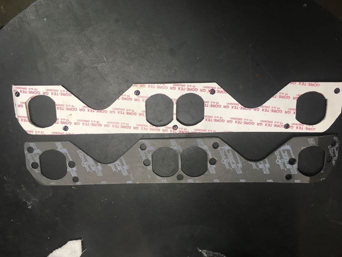

We made our own. And have been using the same identical gaskets for over a decade. Must have been on and off 50 times. No leaks what so ever. I have to give brother John the credit. He found this material that they used where he worked. ( Gore-Tex) They used it in the boiler rooms. We just took a small sheet of it, found a gasket we liked and fit, and copied at a cad table with a knife blade on it. I know why nobody sells them, you would never sell a second set !
This is a second set we cut out by hand but have not needed …...
Jeff,
Thanks for the info. I let my Fingers do the walking on the net. I might have found a supplier near me in AnnArbor, Mi.
Thanks Again,

Jeff,
Thanks they have it at Mc Master Carr.

Default Re: Exhaust Gaskets
Amen, haven’t used exhaust gaskets in years.....
Silicone is a mess. And you have to clean it off every time you take them apart MJ. Call me lazy but I like using reusable gaskets that seal as good as silicone without all the disadvantages ..
