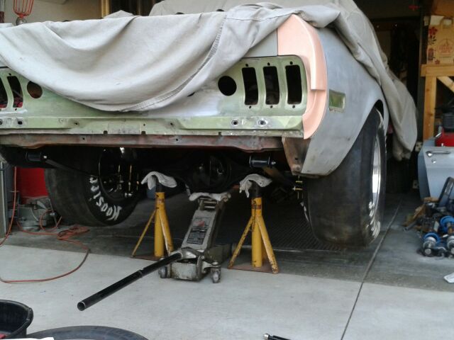

I started on one and I'm building it from scratch ('67 Shelby). It's taking a while since I'm spreading out the cost. you can email me at Mikeg@floorsbysignature.com
if you want to ask any questions. (I'm about 1/2 done and figuring it's going to be at least $40K)
Funny, that pic looks exactly like my garage tonight right down to the Cal Traks, jack stands and floor jack. I even have the passenger side door off my 68 coupe. Small world when you're having fun. Been working on it every day for a year now.
Dale

One more thing, if it's a nice car sell it and get another. I would not have done this to a nice fastback. After you gut the car and alter the wheel well openings there is no going back. Things like heaters, wipers, vents, rear seats only get in the way, you need to get it light and then add back weight where needed.
