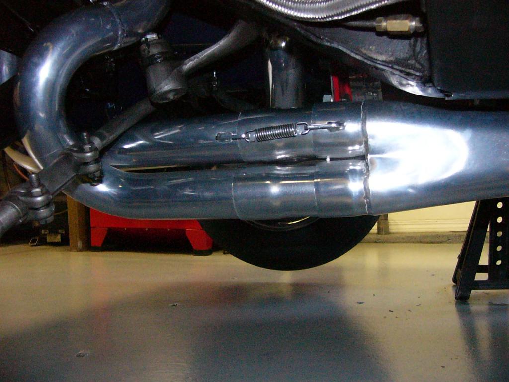

It's another knee jerk cover all the basis fix to a very small problem. I've had my collectors held on with springs for 8 years and never had one come off even after smacking the pavement from a wheelstand gone badly. Maybe the spring keeps the tab from breaking, I don't know.
